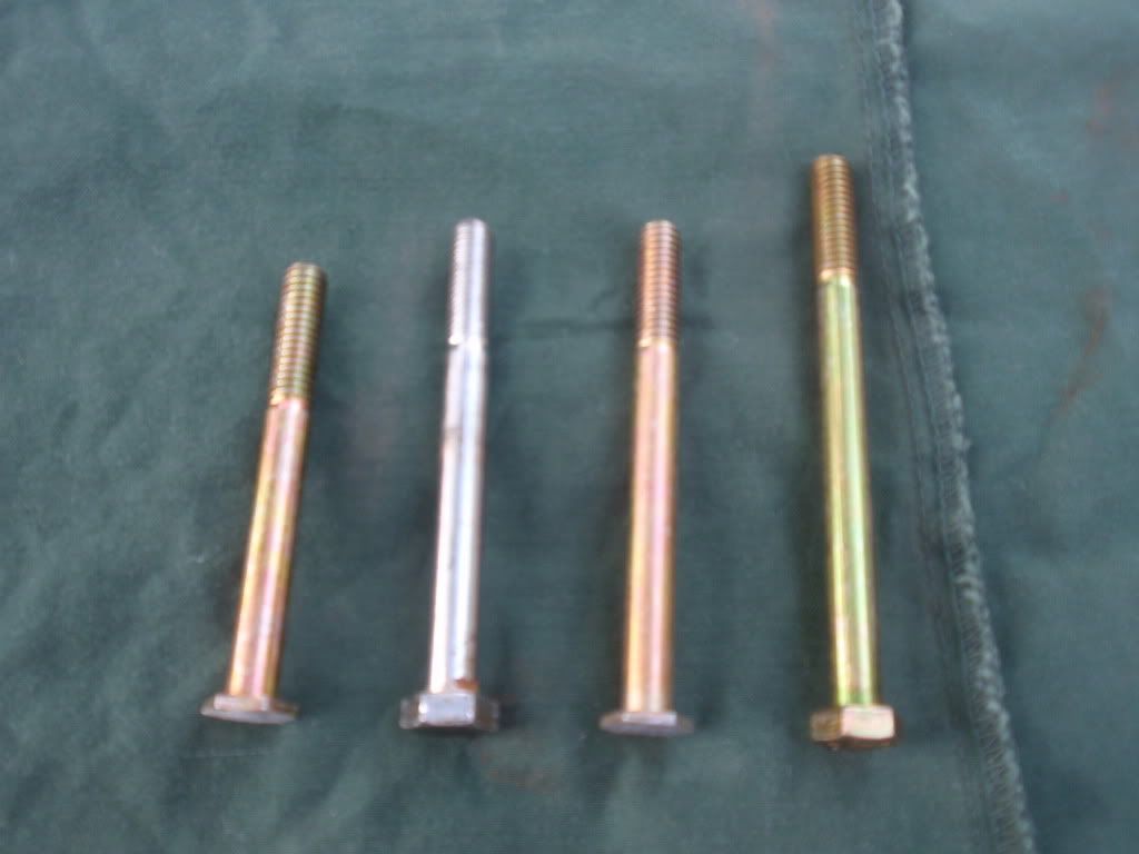

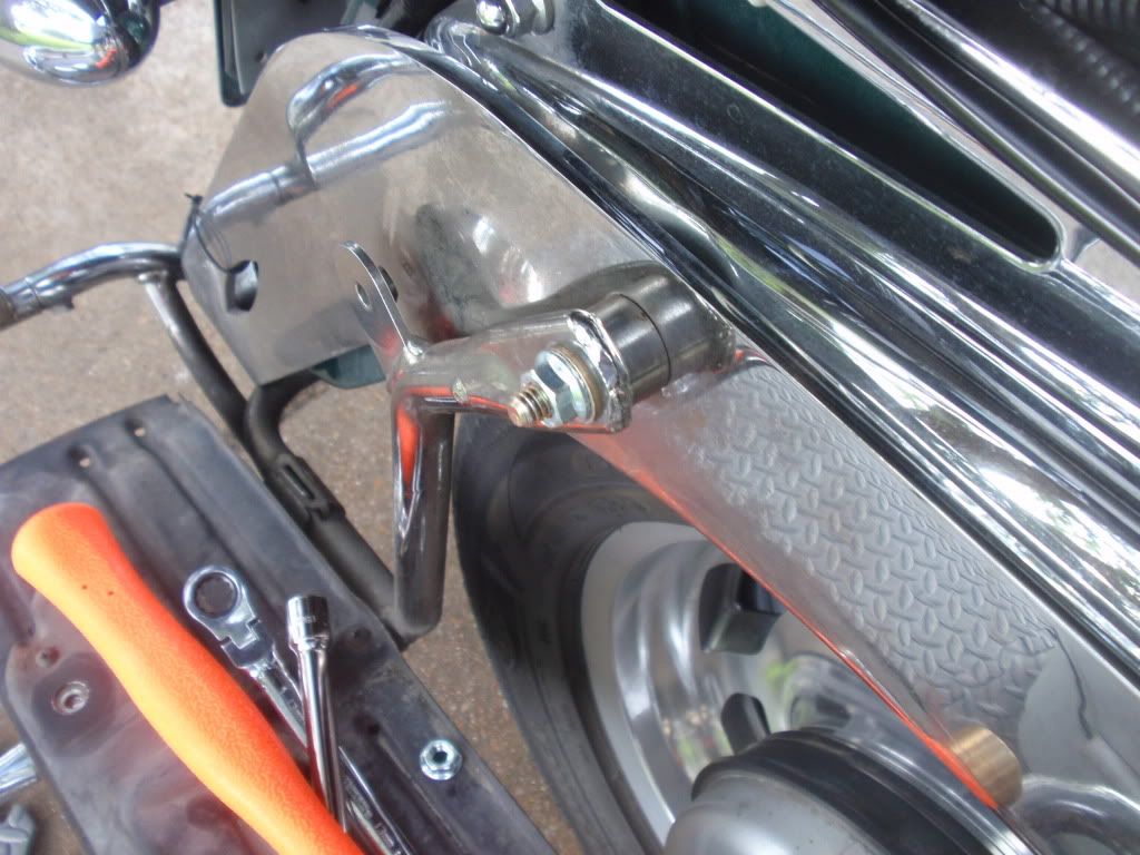

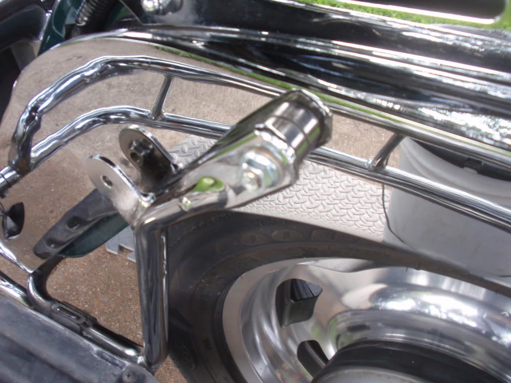

Today was a busy day for me.  I got my passport photos and made a bank deposit.  Then I headed off to Lowes to get a replacement bolt for the one that is rubbing my Goodyear TT.   tickedoff  I got a couple of good grade 8 bolts, one 3" and one 3.5" (5/16 variety) and trimmed the heads of them down by a little more than half.  I don't need the holding power of the grade 8 bolt, but I wanted the "shear resistance" that a grade 8 would give me.  I pull a trailer a lot!

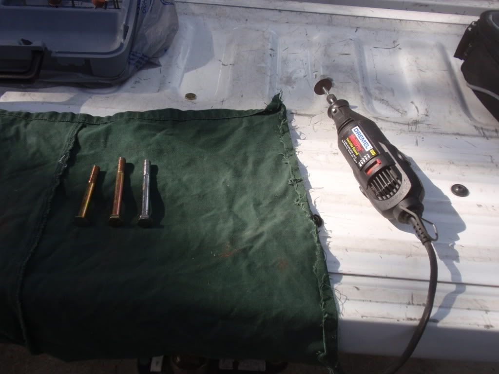

Here is how I did it...  First I got out my handy Dremel tool and put a cut off wheel on it.
This is what the bolts looked like when I was finished trimming the heads off.  The one that came off the bike is the chrome one 2nd from the left.
This is what it looked like before I trimmed the bolt length down about 1/4 inch.
After trimming the bolt down a bit.

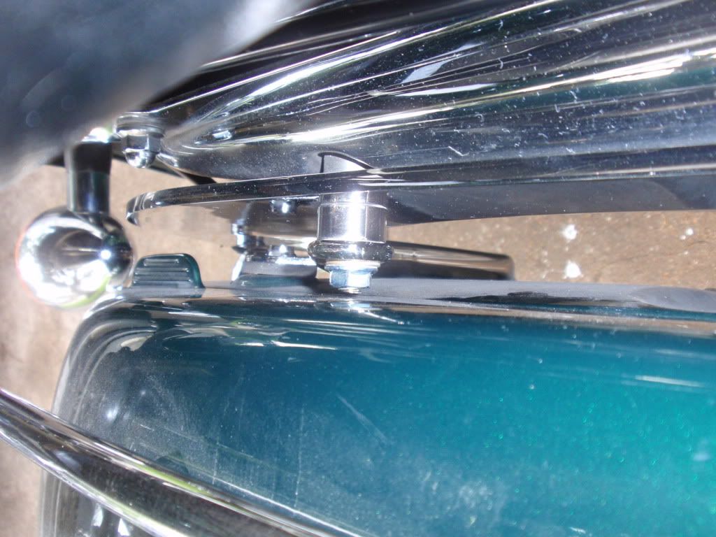

This shot shows the clearance that I have.  It's not much worse than the stock bolt head sticking out.

I ground the stock square nuts that go in the nut cages to about 1/2 their depth for the extra clearance.
Using a grinder to thin it down would be A LOT faster than a dremel cutoff wheel I think.  But still...
