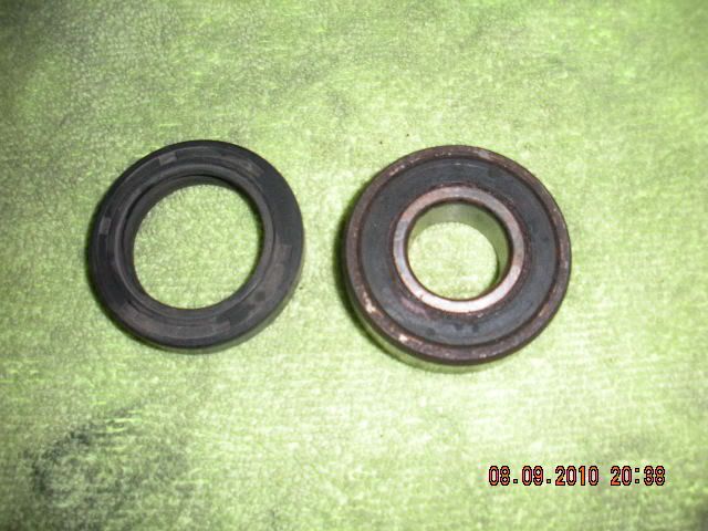

Jeff is a genius  Shocked. Folks I know its hard to believe. When I got back from InZaneX Jeff send me a SMS for an update on our status. Told him I was back etc etc and that my bike had a vibration that I could feel in my foot pegs. Instantly he replied you have a wheel bearing going out. Here is the result.
Right side of left rear seal and bearing Note shiny-er away from the seal.
Left side of left rear seal and bearing.
In my case bearing life was shortend by a bad seal and 1000 or more (s)miles in the rain. I caught it in time without any major damage. Thanks Jeff!!!!! cooldude cooldude

Also will help that every time you have the wheel off, smear the bearing edge with some wheel bearing grease. It keeps dust/water from working on the actual seal in the bearing and will extend the life.

A nice clean spacer and the greese Dan'l mentioned is the kind of thang you can take the time to do yourself that others may not do. I would suggest spending a little more on your bearings at a bearing shop for an upgrade over OEM.

Your '98 takes two 6204 bearings up front and one 6204 + one 5204 bearing for the rear.  When I did mine earlier this year, my local NAPA didn't show a listing for the 5204 (probably operator error) and the 6204 was Made in China.  I got mine at Purvis (Made in Argentina).  They are everywhere and the closest one to you is  TX

I can't believe Jeff hasn't already called you. He probably had nightmare's all week!  2funny cooldude
Check those bearings, there are no bearing seats, don't wait to long because you could ruin a wheel and/or a shaft and your description fits mine to a T. Good luck ~TJ
