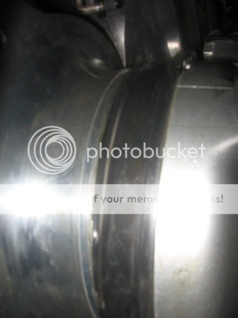

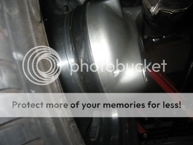

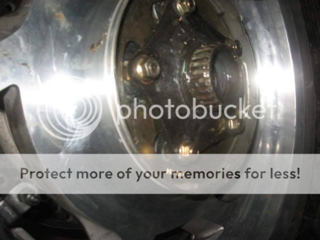

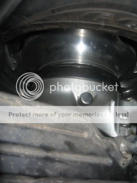

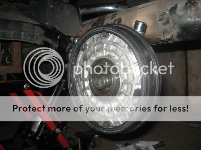

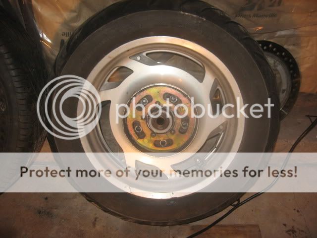

NITRO
Posts: 1002
Eau Claire, WI
« Reply #17 on: September 03, 2010, 06:34:29 PM »

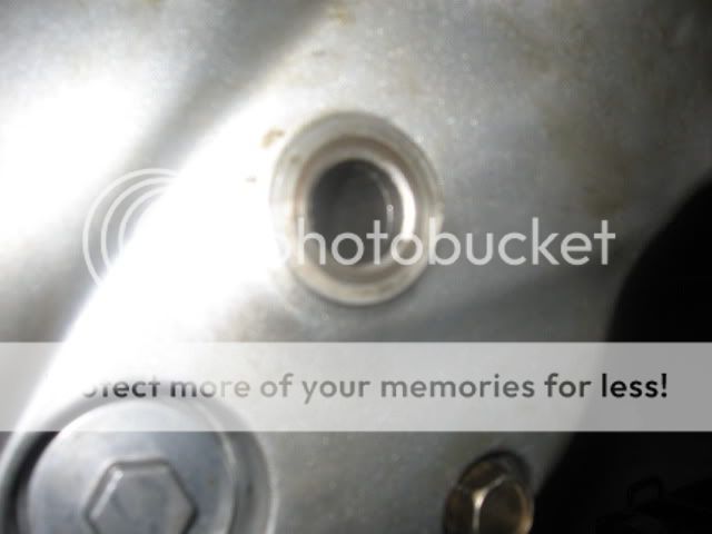

Final drive spacer:

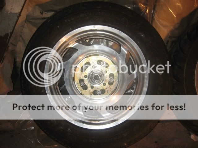

“Old” wheel:
“New” wheel:
The flange in the wheel (this looked the same as the one I had removed in terms of space between the wheel and flange):

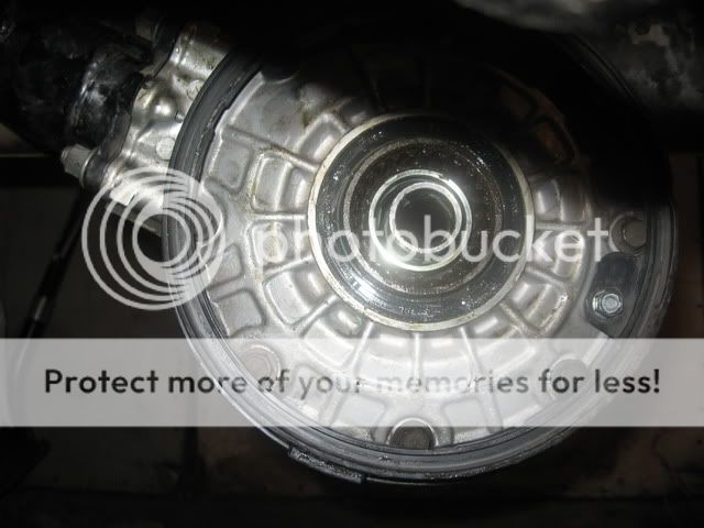

The wheel not mating into the final drive by about .5”:

Posts: 17586
« Reply #19 on: September 03, 2010, 08:30:29 PM »
Taking a look at the pics and reading I have a couple of questions. It looks like the flange 8 is not seated all the way on into the bushings 1. The flange 8 sits on the wheel on top of the thrust washer 5 and the center part of the flange sits on the wheel hub 9 where the bearings 18 go this sits flush or with no space. So you should be able to mount 8 and have the inside lip of 8 sit on the hub where the bearings 18 goes with no space and the thrust washer 5 being the only thing that separates the flange 8 from the hub. The pins that go into the bushings some how may be to long and hold the flange 8 from seating all the way down to ride on top of the thrust washer. Please check that this is not the case the other thing is check that there is not another oring in where the final drive and 8 engage each other. I mean really check with a pick to make sure there is not a oring trapped in there you really cant see them.  In the pic it also looks like you dont have the wheel perfectly perpendicular to the diff. It wont go on like this but it may be just the pic that makes it look like the top is out further than the bottom. The center spacer coming out of the diff sits on the bearing in the wheel. The flange 8 is held in place by the diff gear and the wheel with the thrust washer acting like a insulator so when the bushings give and move dont score up the wheel hub. There should be no space between any of these when the wheel is on
« Last Edit: September 03, 2010, 08:47:02 PM by Robert » Logged

« Reply #24 on: September 04, 2010, 05:47:11 AM »
This may sound stupid but looking at the distance between the dust ring on the pumpkin
and the edge of the wheel (in your pictures) it appears to me to be all the way in.
Have you tried putting the break holder and spacer in on the other side.
Sorry ahead of time, but thats what I see from the pictures.

C. Drewry
Posts: 17586
« Reply #25 on: September 04, 2010, 06:25:48 AM »
Sorry for the lousy pick but as per Lee I posted this so you can see the collar and diff/wheel spacing

I just looked at my spare final drive.  Your spacer is definetly sticking out of the pumpkin more than it should be.  At the bottom of the hole.  The outside of the casing where the drive shaft enteres there is a steel sleeve that stops the spacer.  Make sure (by looking in from the outside of the pumkin) that the spacer is touoching that steel sleeve.  I bet you will find something is stopping it from bottoming out
