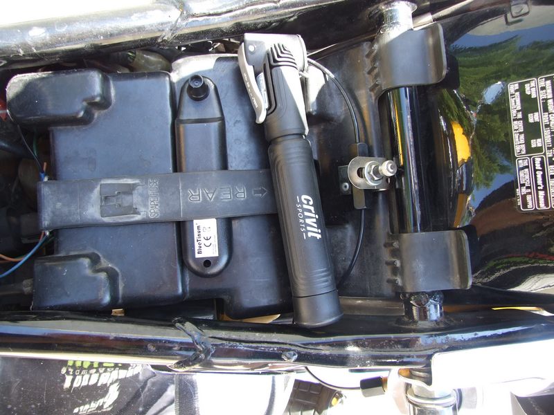

I bought a stainless bracket from the local hardware store, bent it to shape and pop riveted it to the rear part of the battery tray under the seat. I keep an electronic tyre pressure gauge and a small high pressure racing bicycle tyre pump under there too to top it up when I am two up. I can do a photo tomorrow if you want.
I'd really appreciate a photo if you can.  No rush though, the shocks are not expected to ship until 9/10.

« Reply #6 on: September 05, 2010, 06:25:40 AM »
Photo as promised of my setup

« Reply #7 on: September 05, 2010, 06:56:06 AM »
Thanks for the photo.  It looks to be an ideal installation and easy to duplicate.

« Reply #8 on: September 06, 2010, 02:59:12 PM »
Thanks for the pic, Colin.  I've got to do something soon - just not sure what.
