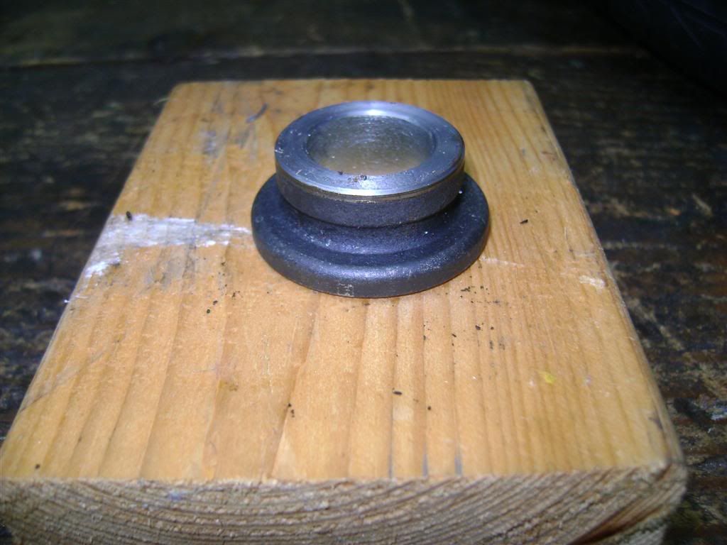

I've replaced ( 3 ) with stock going back in on three different Valkyrie's over a 12 year period....I just went with the double row ( R ) on the ( L ) after doing the spacer mod so I've replaced the left side ( 4 ) times.

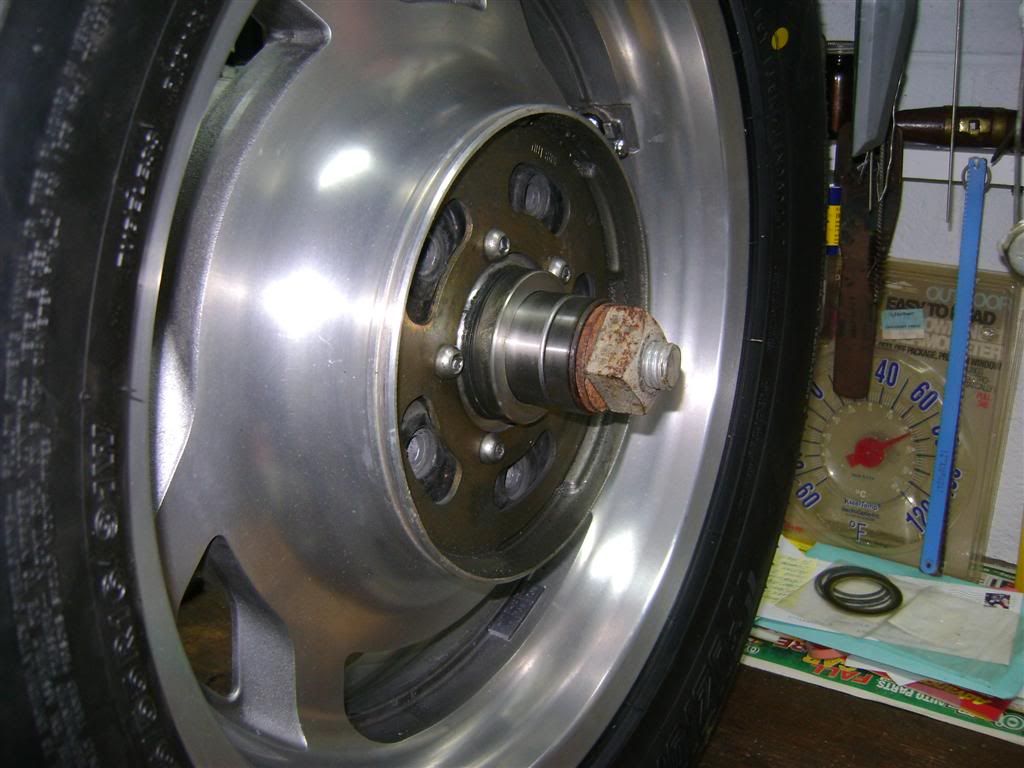

Joe?  Do you loosen the four nuts holding the final drive to the swingarm when you drop the wheel?
If you do... and then re-torque them LAST (upon wheel installation)... you've less of a chance of any axle/wheel/swingarm alignment issues (which could put some preventable stress on that weaker L/R bearing if you didn't).

I pull it all when I change the tire ...I change the final drive hypod oil I clean and re-lube the splines the drive-shaft at both ends , pinion cup and replace o-rings and crush washer. And yes the 4 bolts are the last thing I do....I've seen Daniel Myers do it 2 times at different InZane's.

I only changed mine when they went bad or when checking them at tire change they did'nt feel smooth .The two I've had go bad while riding still got me home I could feel the different vibration in the foot pegs. The last one when I pulled the wheel to change the tire and service the final drive it had a rough spot I did'nt like so I went with the spacer mod and double row bearing on it....Time will tell  Undecided

Replaced mine about 3 or 4 times over the course of 3 years. After the last time I found a replacement rear wheel, had new bearings and spacer installed, had the tire and everything else move to the new wheel and have not had a problem since. Still, I do travel with a complete set of rear bearings and related parts.

I don't know what makes the difference, although I'd suggest those that are having multiple failures on the same bike measure CAREFULLY the wheel casting and spacer. One bike I saw had a "tit" in the wheel casting where the bearing seats and so the bearings weren't going in all the way. Another I saw somebody had broken the "seat" out of the wheel on the first change.
I've not seen one on a Valk, but I've seen badly machined wheels where the distance between the bearing seats was NOT correct and some that weren't square to each other. That would lead to premature failure for sure.
Anyway, the left rear fails pretty commonly on many different Valks...indicating it's marginal on size/design. Bearings don't last forever, but they just shouldn't fail easily either. Multiple failures on the same machine, to me, indicate something else could be going on and some VERY close/technical scrutiny is an order.
The only thing I do differently to mine is each time I pull/replace a wheel, I smear a little wheel bearing grease on the edges of the bearing...covering the bearing's own seal. My theory is this keeps that seal lubed and less prone to fail, and the grease I put on helps keep dust/water on the outside (I wipe off and re-smear every time). I also change the dust seal in the wheel reasonably often.

I think the left bearing mod is probably a good thing, but in my opinion the bearing's seal is not adequate to leave openly exposed in that environment (let's NOT forget brake dust on that side which is very abrasive) and would lead to premature failure ... so that viton seal/cover or getting the dust seal to give the bearing seal some additional protection (and in my case giving me a place to smear some grease) is very important.
