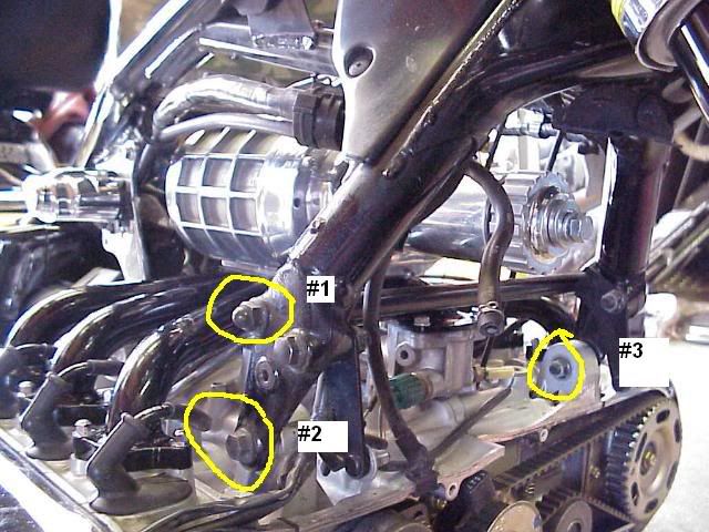

Ok, I think I have the BuzzBolt problem.  I can't seem to find it.   I looked at the 'coolant' parts list and can't find a bolt that goes all the way across......
http://216.37.204.203/Honda_OEM/HondaMC.asp?Type=13&A=257&B=62
Does anyone have a picture of where this ominus bolt is?  Or some way to describe it?

Is it one of these?  Or am I even close?  I got this from the Valkyrie Shop Talk page...

« Reply #9 on: April 28, 2009, 07:51:13 PM »
It is # 1...............   Hit it with a good strong impact wrench and no more problems....
Posts: 14911
« Reply #10 on: April 28, 2009, 07:52:06 PM »
#1 in that picture is the culprit

« Reply #11 on: April 28, 2009, 08:00:12 PM »
It's number 1 in that pic. I don't a picture, but I found this drawing. It is looking at the front view on the left side.
http://www.rattlebars.com/valkfaq/buzzbolt.html
