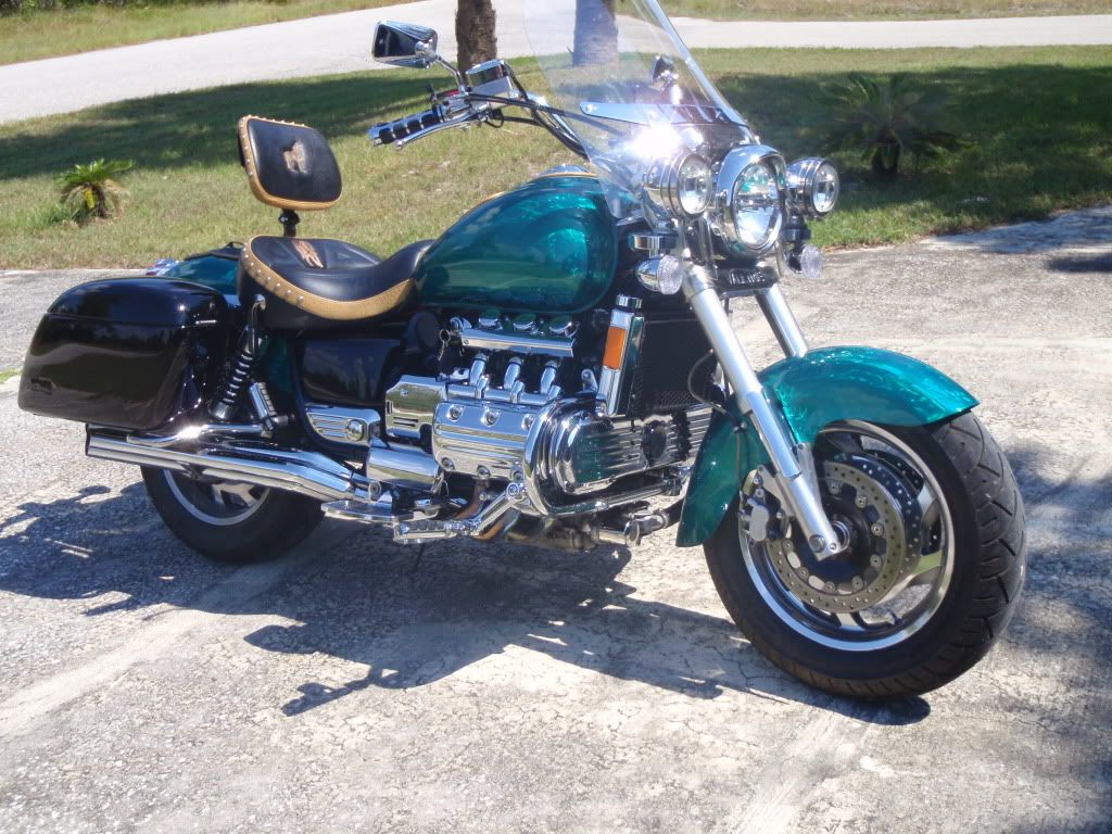

Did you get yourself another Valkyrie TJ ?
Yep,
