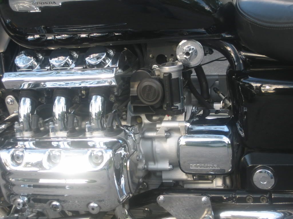

vanagon40
Posts: 1473
Greenwood, IN
« Reply #6 on: April 02, 2009, 10:08:26 AM »
Disco
Posts: 4914
Republic of Texas
« Reply #7 on: April 02, 2009, 10:24:00 AM »
Here's mine mounted to the inboard bolt on the sidestand cross member.  It's 2 pieces of 1.25" x 1.25" x .125" aluminum angle, bolted together, bolted to the bike, with a hole for the horn's mounting bolt.

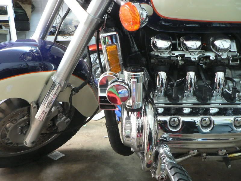

fordmano
Posts: 1457
San Jose, CA.
« Reply #15 on: April 02, 2009, 11:16:43 PM »
May not be what you want to do but here is mine. looks ok to me but mine is the chrome model.
If you look closely (its black and hard to see) I have a 12volt lighter socket right there next to the horn, yes the petcock switch is missing I am in the middle of a lighting project and a few other changes
