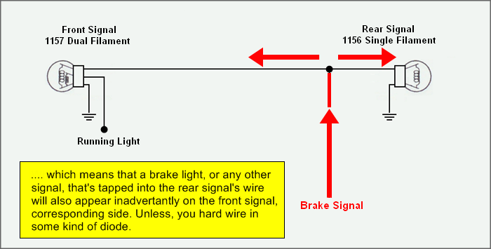

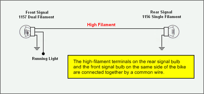

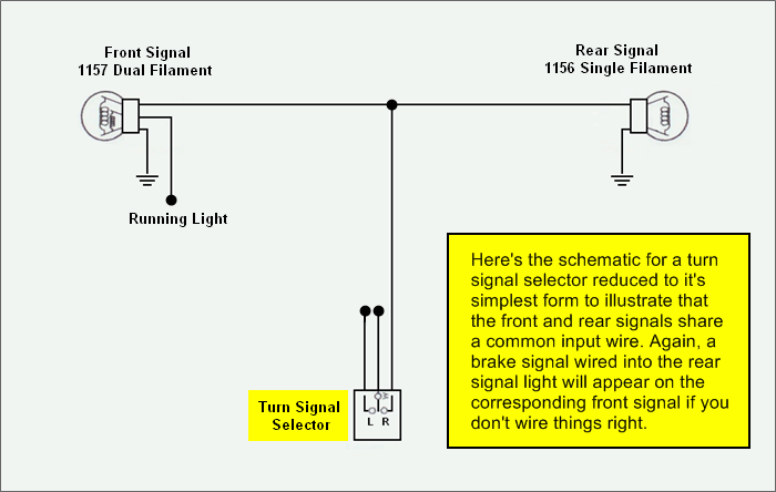

« Reply #5 on: January 23, 2011, 06:56:02 AM »
Here's something to be aware of, if you weren't already, when retaining the stock 1156 rear signals for a brake/running light conversion.
