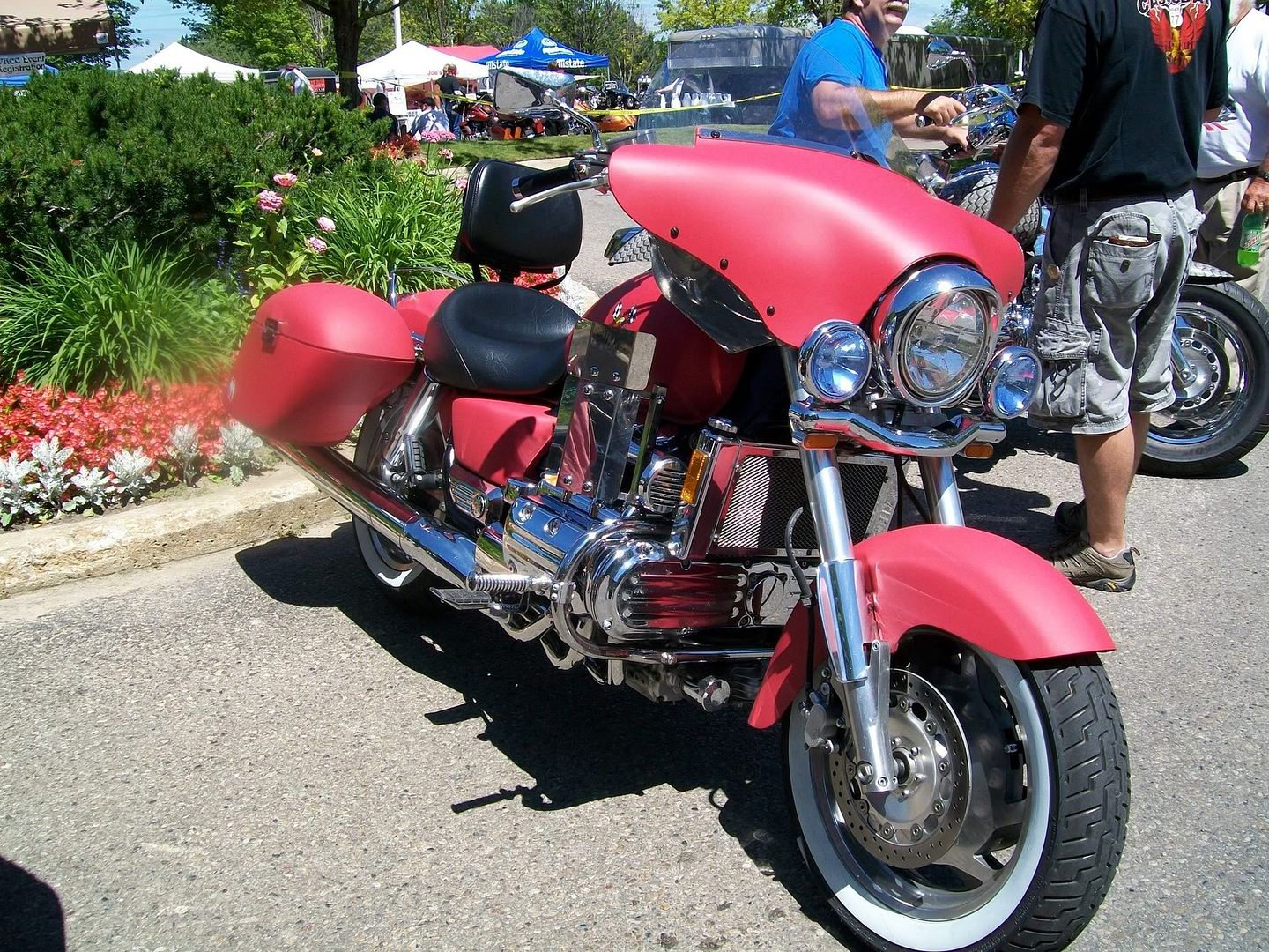

This bike belongs to a Wisconsin brother, if I recall correctly, his front is a 140/80/17 by Dunlop, rear is a 180/65/16 Dunlop.  He is on this board frequently, pic is from last years Inzane.  Hoser  cooldude

That is my bike with the whitewalls, Hoser is correct on the sizes, the rear is only available through Hardley dealers, the fronts are available at most large MC tire dealers. The sizes are extremely close to the valk originals, they are bias ply not radials.  So far no negative impact for me.
