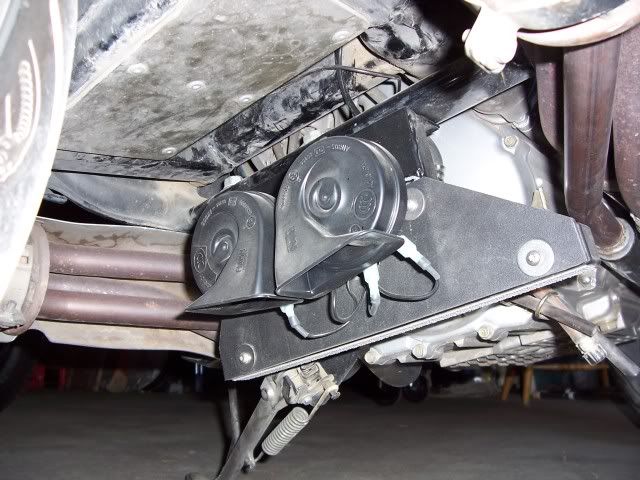

john
Posts: 3018
tyler texas
« Reply #17 on: January 26, 2011, 04:59:41 PM »
 Go to BigBF.com Bill has what you need.
roger that   ! !    cooldude
quad setup tucked  away  nicely   ....     coolsmiley
