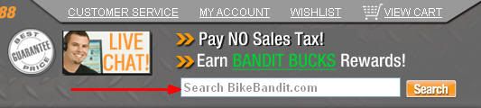

« Reply #13 on: January 28, 2011, 04:47:56 PM »
Do like I did and go to a Trike Shop. I found a like new take-off u-joint from a 1500 Goldwing for $40 .... The u-joints are same for Valkyrie & 1500 Wings.
My understanding was that mother Honda had some sort of trouble with the manufacturer of those... as a result, they had to seek a new vendor willing to make them to Big Red's mighty specs...
Now... if it IS true, this same part fits the 1500 Goldwings and I believe it is... that is a huge incentive for Honda to get these replacements back on the shelf ....
It is TRUE .... go to bike bandit and key in part number 644090 in the search area.... and then click the "Fits machines"   -  Fits 46 machines !!!! '88 Wing all the way to '03 Valkyrie   cooldude
