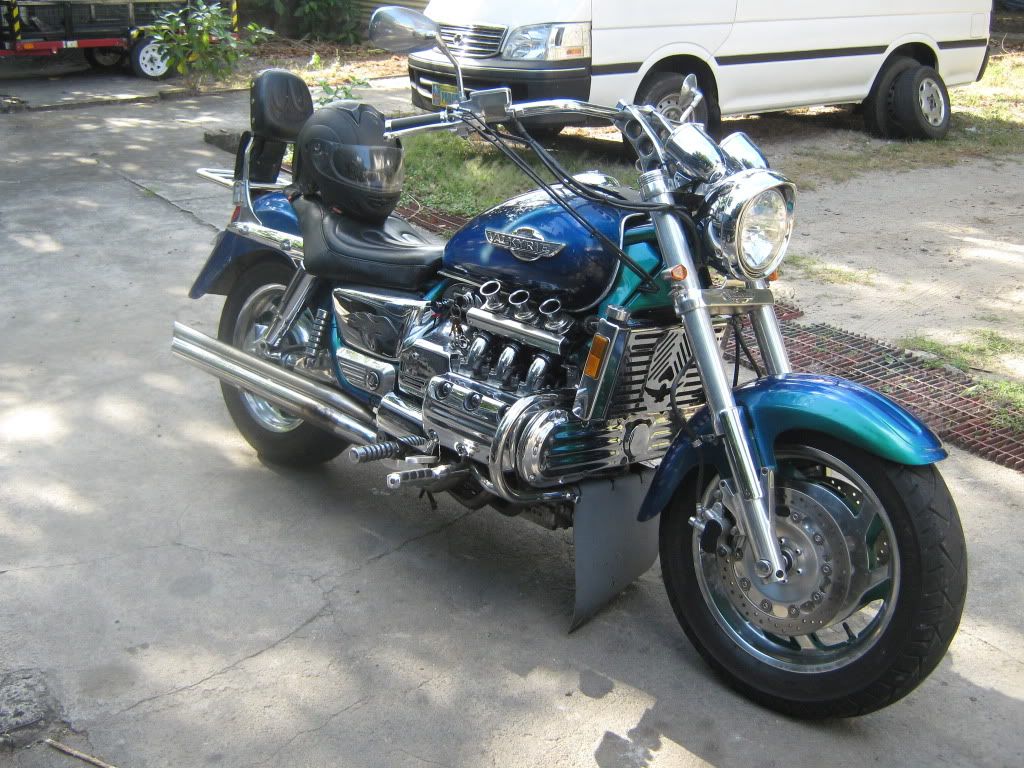

« Reply #8 on: February 24, 2011, 07:49:39 PM »
Sad
A few pics as to what to expect...!
All done and repaired - (Faulty Petlock) I was lucky cost me approx $350 to repair!

« Reply #10 on: February 25, 2011, 07:26:34 AM »
Bilks,  I love your saying about money and church.   Grin cooldude
Looks like the case is broken in the pics?  Did you fix it, replace it or just used it as is?

« Reply #12 on: February 25, 2011, 08:17:12 PM »
 Undecided
All was repaired, the cogs were copied and replaced the originals. I was not involved in the "surgery" my local French mechanic was the bike Doctor! Did a fantastic job and the bike runs sweet now!

« Reply #13 on: March 28, 2011, 08:24:14 AM »
If I'm looking at the pictures right, You didn't have to pull the engine, just the rear drive unit and rear case apart??
