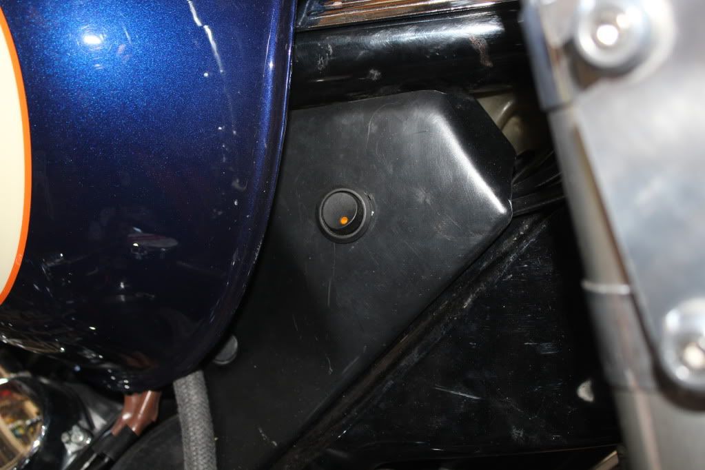

I run mine with my low beams pretty much all the time, but I also have them on a switch.  They're on a separate, fused circuit with a relay triggered by the headlight wire, so they go off when the starter button is pressed.  I don't use them so much to see as to be seen.

I too have the Cobra light bar. I switched the bulbs for 36 watt halogen flood lights and if the engine is running, my lights are on. Your 55 watters are very bright. If you use a relay and switch them off with high beams, you can toggle between high and low beam as you approach a crowded intersection. My old 1100 shadow was wired this way and that's how I used them. The switching attracts a lot of attention.

I don't have Cobra's, but I run my lightbar off of a separate relay and switch.  They are only on when I want them to be.  I usually only run them during the day.

Mine are on any time the key is on, except for when the starter button is depressed.

55 watt mounted on the engine guards, switched/relayed using the accy. circuit. Key goes off so do the lights.

run mine pretty much all the time. i use the engine kill swt to control a relay. switch power comes from the headlight  circuit so the are off during start.

Figure I'll run them all the time, as I'm in the same boat - I work midnights, so most of my "daily" driving is 10 at night, and 7 in the morning. And going the opposite direction than everyone else. Of course, with OUR daylight savings time, it's light out, until 9:30, almost 10:00, in the summer. I like the switch in the front side cover! I have my relay for my horn there, I'm sure I can get a switch. I WOULD like to be able to shut them off, when I want/need to. Mostly, I was worried about being stopped, but it sounds like one of those "don't worry about it" things. I'm hoping the amber running lights are the same. If I do have trouble, I'll make some LED's like electricalconnection's, but I really don't like the looks of LED's mixed with incandescents. I guess it's because of the Christmas lights. I run a computerized Christmas light display, like the one that was on the Bud commercial, and I just can't bring myself to mix the two types of lights, and it carries over into the motorcycle.
