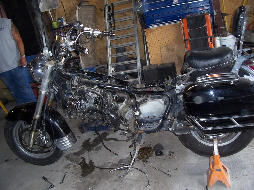

« Reply #10 on: February 01, 2011, 04:46:42 PM »
Posts: 10651
« Reply #11 on: February 01, 2011, 04:53:07 PM »
Not bad Roadkill, just about a whole bottle.  Grin
RoadKill
Posts: 2591
Manhattan KS
« Reply #12 on: February 01, 2011, 04:55:06 PM »
Gunslinger and I go  this far in an afternoon with Jim (beam) assisting. why would you fight doing this in the bike?
Gunslinger
Posts: 404
Brian Huntzinger, EMT-P
Wamego, KS
« Reply #13 on: February 01, 2011, 04:58:22 PM »
Exactly my point...
This isn't even a one bottle project! Why replace the gears in the bike when you can drop the motor in a few hours?
