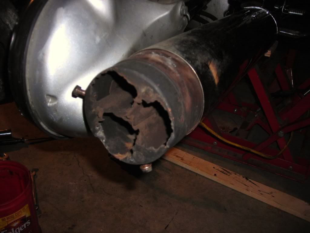

Thanks for the info.  Here's what I'm dealing with.  Not pretty. AAHHH?  (First time posting a picture, how do you do it?)  Anyways, until I figure that out, it looks like someone with a hatchet cut the baffles out.  What if I got another set off e-bay and had the chamber(?) attached/welded to the pipes just passed where the chrome ends?  Are there any after market pipes that are close to quiet as the oems?

« Reply #6 on: February 01, 2011, 09:35:22 AM »
Thanks;
Bill
You might be able to mix and match parts and come up with a decent looking set of pipes, but your best
bet is probably to keep your eye on eBay/Classifieds/whatever and pick up an already decent set for
$300-$500...

« Reply #7 on: February 01, 2011, 06:30:09 PM »
Got the picture thing figured (Thanks Ricky-D)  Thanks everyone else for the posts and info.  I found what looks like a decent set, we'll see.  This is what I found when I took of the 24" stack extentions.  Nice!
fordmano
Posts: 1457
San Jose, CA.
« Reply #8 on: February 02, 2011, 12:07:59 AM »
Ouch! Shocked
As others have said just buy another set of untouched stockers and save yourself LOTS of headache and frustration.  cooldude

« Reply #9 on: February 02, 2011, 12:55:49 AM »
Looks like someone did what they call a Ragnar cut on the exhaust.

« Reply #10 on: February 02, 2011, 06:33:06 AM »
I think that looks pretty normal actually.
Trying to remove the guts will take you down the same road
and you can do a lot more to get additional "insides" out.
Just need the can to remain in order to attach the final end piece.
Seems that the additional support supplied by the piggies is "no big loss".

« Reply #11 on: February 02, 2011, 08:16:55 AM »
I condsidered that that was the way it looked when you cut the piggy's.  Never done it.  But it bothers me that something on the bike looks that hacked, even tho you can't see it.  Maybe I'll get over it?  It's strange, but it wouldn't bother me if it was on my car, or truck, or bobcat, or excavator, or just about any other machine.
Posts: 16815
« Reply #12 on: February 02, 2011, 08:25:40 AM »
I guess what it looks like when you are done is determined by whether you have cutting tools and drills, or just a crow-bar
or maybe a shotgun  Wink ...
Mine looked like this when I got the bike, piggies cut and baffles drilled... I hated it...
