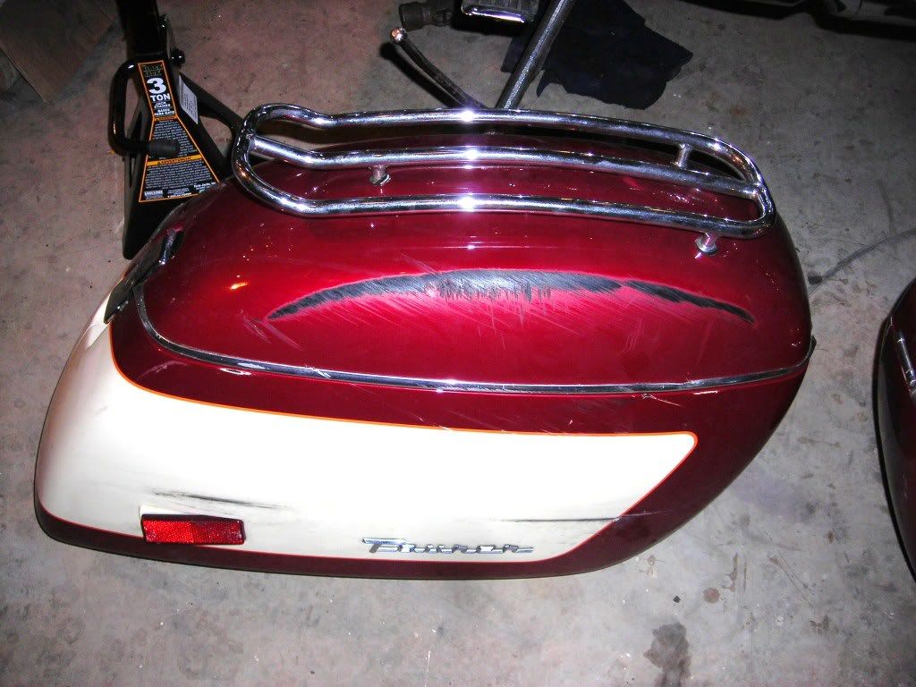

Soon I'm going to need to paint my tank and bags on the two tone Ct. (Burgandy/cream)  What's the story on matching the oem paint?  I'd like to not have to change the side covers and fenders as they are in prety good shape.  My painter ask if the I thought the original paint on them has faded much.  I said I thought they looked better much like new.  Also should I try to hunt down the Honda paint or something different?  What about the pinestripe?  Is that something I can match?  Does any one have any experience on this that they could pass on to me.  Thanks   Bill

Thanks everyone.  Just like in anything else, we've all had different experiences and this board brings them all together.  So, seems like my options are.   Colorite will have the paint but is $$$?  My local Chrysler place will have the Burgundy cheaper but not the Cream?  Or I could just take a bag to a paint store and hope they match it?  Anyone ever deal with the pinstripe?  That must be a third color code.  I know the codes are on the bike and listed in the service manual, but getting my hands on the right stuff is what I’m in the dark about.  My paint guy will probably know all this stuff, but he’s been out plowing snow since October or so, I think.  I’d like to be prepared if it stops snowing anytime soon.
Gotta fix this, I can't stand looking at it. Thanks Again!  Bill
