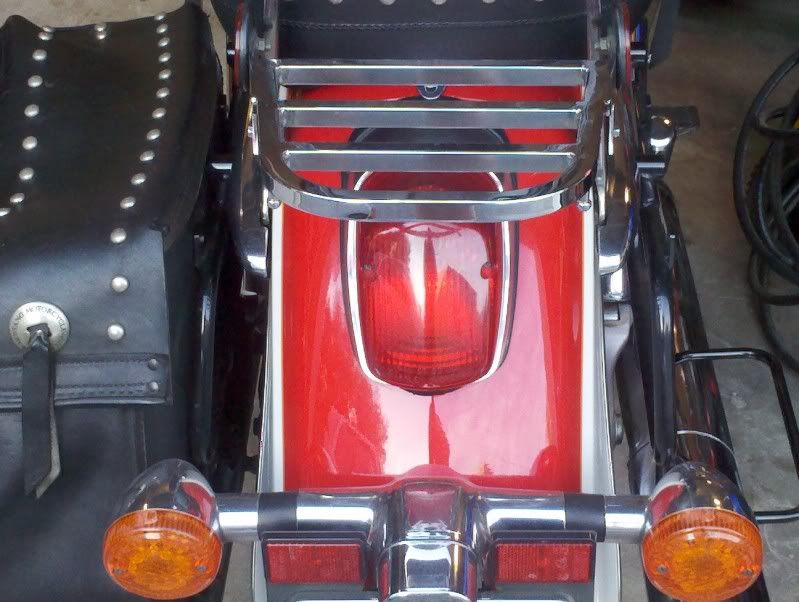

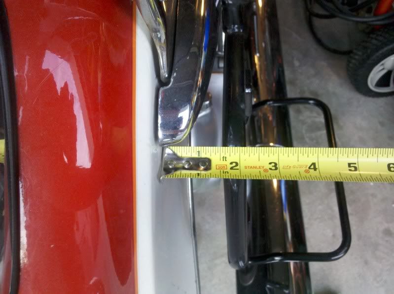

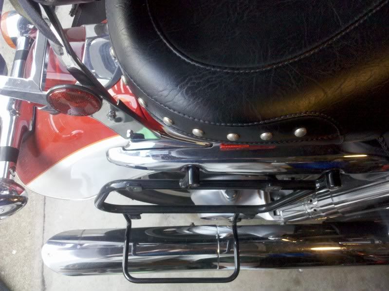

« Reply #8 on: February 06, 2011, 10:45:29 AM »
I'll take one of the bags off (doesn't take but a minute or two) later today and stick a tape measure there and take a couple pics for you.  Will post back later today or tonight.

« Reply #10 on: February 06, 2011, 05:15:19 PM »
The bottom of the support sits 2 5/16" from the top of the pipe.  It's alot of room.  The OEM hard bags sit alot lower and are alot closer to the pipe than that.
According to Mustang's site, the bags are 15" tall.  I don't see how they can be mounted without cutting off that lower support and still get them to look right.  I think they'd sit too tall on the bike if the lower support is left in place.  They might even interfere with the pilion/rear seat since the OEM leather bag mounts sit alot closer/tucked in more to the rear fender than the EasyBrackets allow.  There are still four mounting points per bag on each mount.....and with the mounts being rock solid, IMHO, I think that there's plenty of support for the bag without that lower support being there.
Which ever way you go, good luck with your install.......and please post some pics when you get done.   Wink

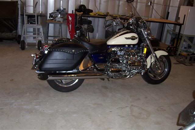

« Reply #11 on: February 06, 2011, 07:22:31 PM »
Great info. Mine is thew Blue and Cream you have pictured. Your pictures answered my questions. Thinhing about ordering some of the brackets and extend the bottom piece so the support will still be there. Then if the top mounts will be cut off and welded to the bottom of the bar instead of the top. That should work. Once I start the project I'll take some pictures. Thanks again for the pictures.
