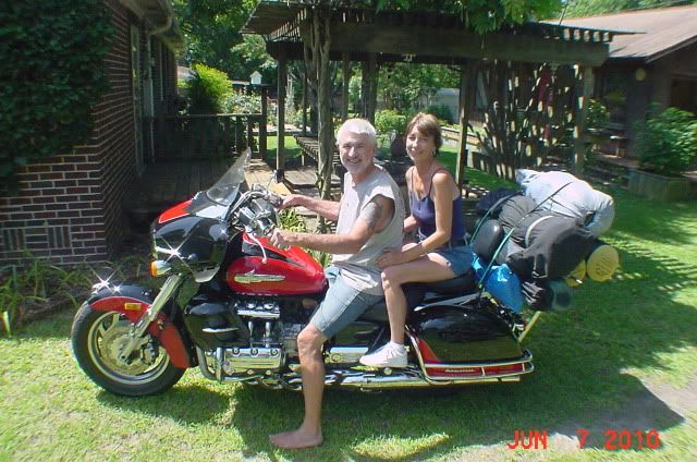

« Reply #16 on: February 06, 2011, 12:24:46 PM »
Here's a pic of my bike showing how loaded the back is!
I fabricated the rack out of material from Lowes.
Could not feel any difference in handling but I could feel the extra weight.
Round trip from home to the ROT rally in Austin Texas.
Note the vertical supports under the rack.
