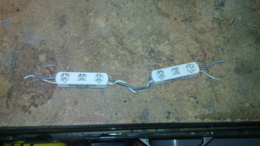

Newbie here, thought that I'd add my own mod here, hope you don't mind. For those of us with the el cheapo  "VIP"  trunk with LED lights ( This one ). You may have noticed that the LED's are none too bright in the "spoiler" light bar. Also the side lights turned out not to have brake lights at all.
So I went digging at Tanner Electronics for HI LED's and found these babies there:
3 LED's in a pack, pre-resistors and all, just hook up to 12VDC. Even with nice adhesive patch in the back. Just what the doctor ordered

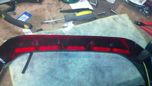

5 of those modules fit inside the light bar chained just nice, once I had binned the old LED board with the stupid "running light" feature

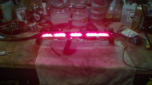

A little dry run for testing, looking pretty good IMHO

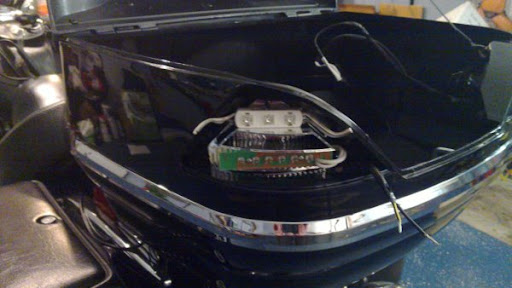

....add a couple more into the side lights.....

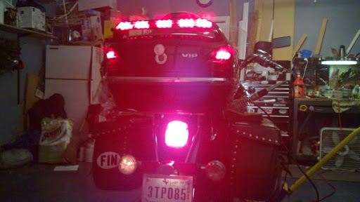

And after some feverish soldering, taping and shrink tubing......
... let there be LIGHT!!
Not bad for $3.95 a pop LED modules and an afternoon's worth of tinkering in the garage  Cool
