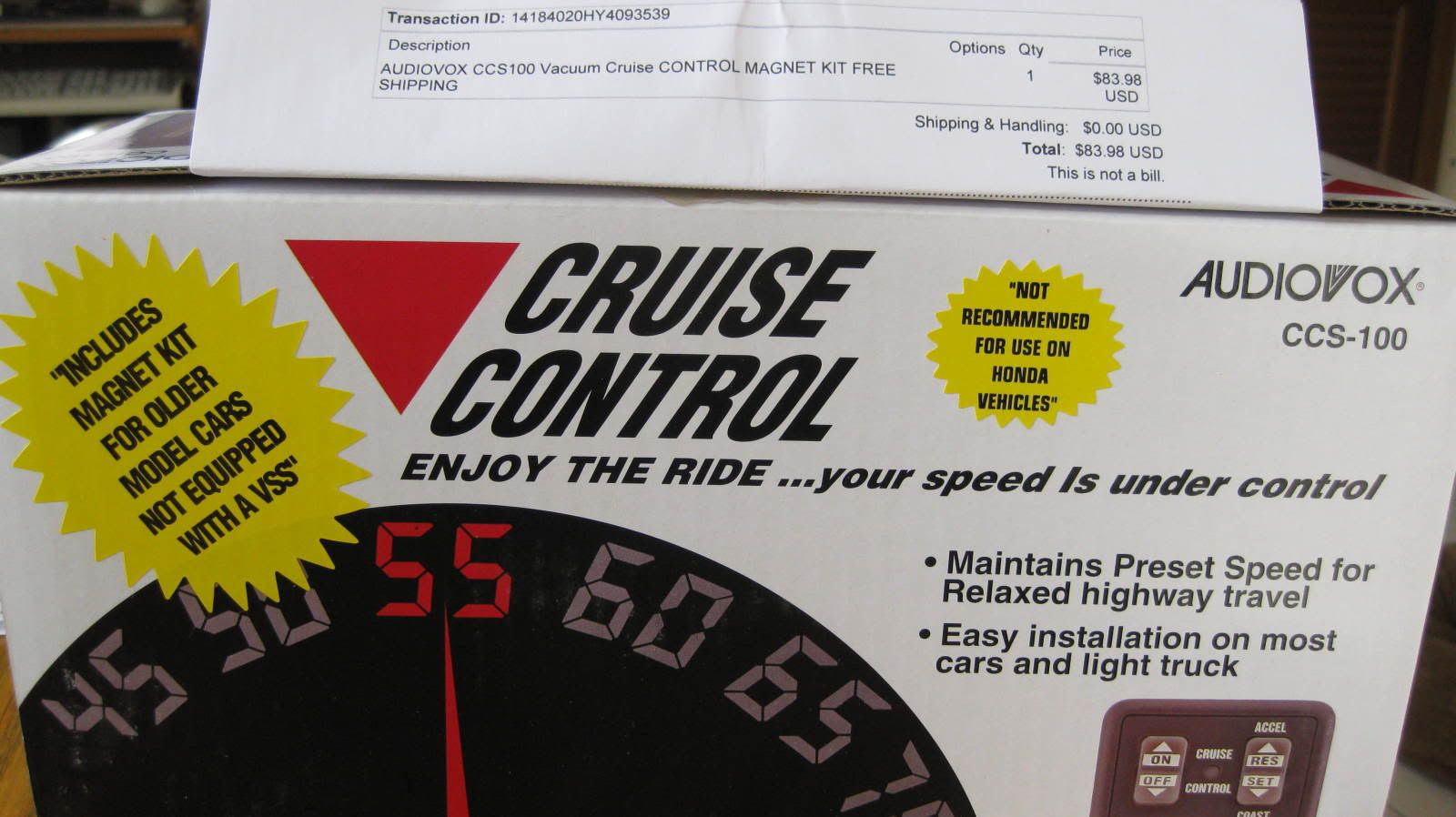

« Reply #1 on: April 11, 2009, 05:45:19 AM »
In answer to your question, no.  Did you waterproof your switch in accordance with Shop Talk?
Call Audiovox and try to order the switchpad & short harness that comes with it.
If that doesn't work, you can get a complete new kit for less than $85.00. I just ordered one for my Rune.
