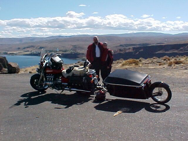

I pull a Uni-Go trailer (single wheel trailer).  It's about the same width as the Valk and sits right in the slip stream.  I get exactly the same mileage with and without the trailer with a light load.  A heavily loaded trailer causes me to lose about 1 mile per gallon.
I'm guessing that the wind drag makes most of the difference... not the little bit of weight that gets added.
