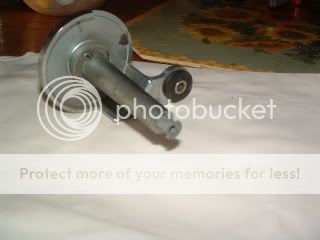

Hey hubcap,  thanks for the reply... The microfisch blow up there is cut off at the right lower corner so I can't see what might be #7 .   The petcock on mine looks like it broke flush with the petcock where the shaft from the selector meets with the petcock.  In other words ... at the petcock, nothing to put your fingers around...
 Here is the face of the petcock...
I took the selector off just now.  It was just hanging there anyway.  Here is the end that broke off the petcock.
 What do ya think?
Wish I had more time right now to investigate further... ie; take off gas tank etc.  I'm getting ready for work right now and doing 3...  12 hour shifts till Thursday.
Sorry for the terrible pics... I'll get better ones when I have more time.  Hope ya get the idea though.

looks to me like your petcock broke off,,, that screw is screwed into the piece sticking out of the selector,,,yep its broke.....

After I bought my 2000 Interstate, I discovered mine was like that also. I think it happened when the previous owner had the carbs cleaned. I ordered a new stock petcock assembly, installed it, put it all back together, and it works like brand new. When done, just dont try to force it either way. There are only 3 positions - on, off, reserve.

The petcock on mine looks like it broke flush with the petcock... What do ya think?...
I think yours is busted. Send me your address in email and I'll send you Tundra's petcock...

Ya... the previous owner here was my late brother Mac.  It was broken when I inherited the bike. Don't know if I can save the selector and just get another petcock... I'll have to examine it more closely when I get home from work today... I was in a big hurry when I removed it this morning while getting ready for work.
-Mike "when I get back from Texas..."
Thank you so much Hubcap... I e-mailed you my info.  Thanx for your help.

Thank you so much Mike... cooldude It was in my mailbox when I got home last night.  looks to be in good shape and a vast improvement from what I have.  Next day off is next Friday so, unfortunately, won't be switching them out until then.  You're a stand-up guy.  angel
Saved me some bucks.  Will let you know how it comes out.
Patriot Guard Riders
« Reply #23 on: April 15, 2011, 08:27:56 AM »
Tundra's the stand-up guy who donated it in the first place... I vacuum tested it right before I put it in the box, it
seems to work fine, remember that the big diaphragm in it came from a pile of used parts...

After you have the tank back on, leave the fuel line off till you have the selector hooked up, put vacuum on the diaphragm with the selector in te off position. If it flows fuel you may have to reposition the petcock to remove side load from the selector. Side load holds the ball off its seat and stops the manual part of the valve from sealing.
Next let the vacuum off and then turn the valve to on, there should be no flow. If there is flow you either have a diaphragm not seating or the bleed orifice is blocked and holding the diaphragm off it's seat.
Cheers Steve
