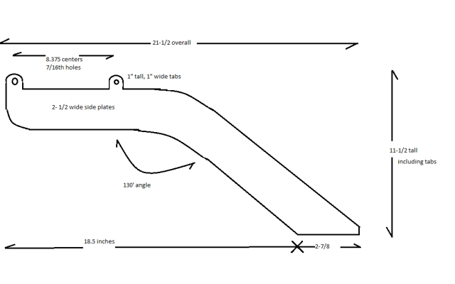

I haven't made these, but downloaded these plans from the board some time ago. I apologize that I don't know who to credit for the images.

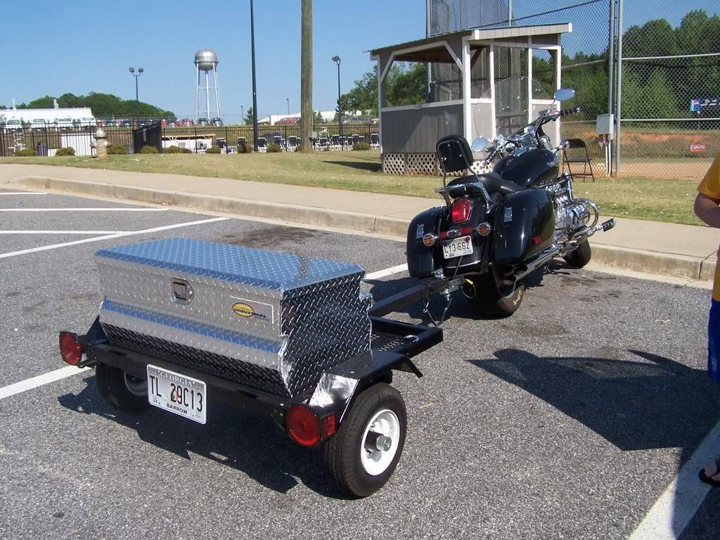

why don't you go to daryl at xf6-custom.com..... he has a beautiful stainless steel trailer hitch for the valkyrie.

I built mine using those same plans. I probably have 20k miles on it. No problems at any speed. Paint it to match and it is hidden. Well, somewhat but it was cheap. I bought everything I needed at tractor supply. Nothing fancy but it works for me.

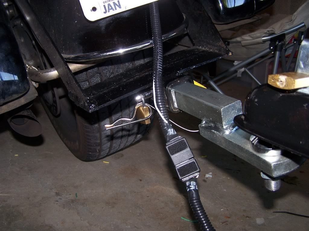

The orginal plans are some that I drew up years ago. I did mine on a trial and error field fit type bases. Still the plans will get you close and you may want to adapt some changes along the way. My hitch is still  working as good as the day I built it some 8 yrs ago. If I build another I will swap the top rails so the flange would be turned to the outside and just make the bottom plate longer to make it work. My hitch is real close to the bottom of the fender and a very tight fit. My is painted black and is barely visible to the untrained eye.

It really don't take long. I know mine is not pretty but I think it took 3 hours, maybe not that long. 5 pieces of steel. Measure and cut. Line it up and tack weld. Weld it all up. (about 30 minutes welding is all) Let it cool slowly because cooling it fast will harden the welds. Drill 4 holes while it is hot. (easier) Square up the reciever tube and weld it. Pant after it cools. Rattle can works for me. I know some here are profectionist and will take it somewhere to paint or have their shop. I also know some like the chrome $300.00 ones but my info is for the ones that would like to build their own. I also want to build a centerstand in the near future. The kind that don't stick out on the side and get ground off in the twisties. lol

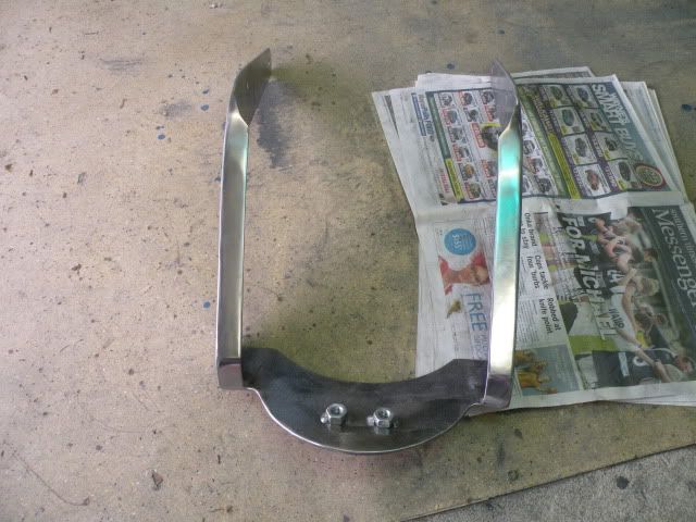

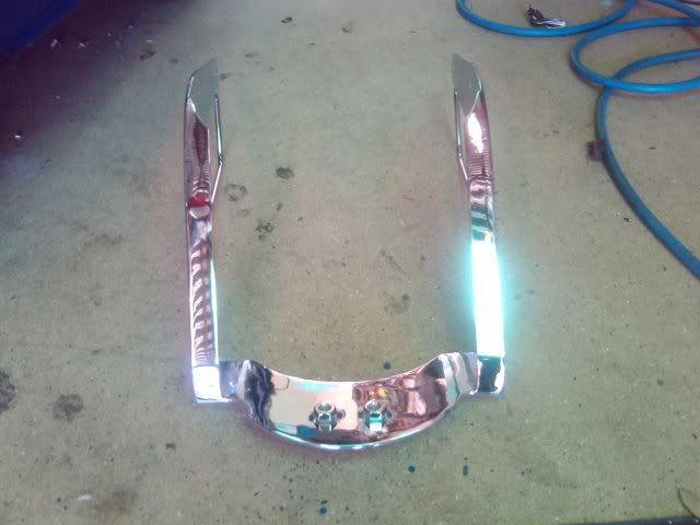

Yes I agree that manufacturers of products for the valkyrie should be supported but there will always be people that prefer to do their own work if possible .People have been customising their rides since the dawn of time before all these parts were available and will continue to do so.I for one get great satisfaction in making the part myself. Unfortunatley the avaliability of parts in Australia is slim at best and the postage cost for large items is over the top to say the least.May be we should all take our bikes to a dealer or the like for an oil change
P.S. Unfortunatley cant ride the Valk 24/4 so might as well make something whem im not polishing it.
This is the end result of my home made tow hich that I got back today from the platers

« Reply #18 on: April 15, 2011, 05:36:00 AM »
Nice!

« Reply #20 on: April 15, 2011, 05:08:41 PM »
Sure looks like both you and the "Plater" do beautiful work!!!!!!!!

With all due respect to any old timers, I (a newbie Valk I/S owner) just went to the xf6-custom.com page for Valk accessories and could not find a Valk hitch.
True enough.  Daryl didn't sell enough of them to continue them as a regular production item.  He did say that if he had enough interest he would do another run of them.  If you're interested, contact XF6 and ask him specifically about the trailer hitch.

The 1/4in plate is a bit of an over kill but I'ld rather err to the heavy side than the light. The plans that are floating arround are of the first hitch I built many years ago. I used 1/8 plate but ended up going back and adding a 3/16X1 in stifferer to the brackets as the hitch had some sway to the left and right. I've have used this hitch for many years with no problems at all.
  Since then several people have used these plans as a starting point to build their own hitches. If I ever build another the flanges at the bottom will be turned to the outside to make it easier to remove the center section for tire changing.
