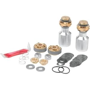

That Race-Tech Gold Valve bidness seems pretty interesting... hmmm...
http://www.amazon.com/Race-Tech-Gold-Valve-FMGVS2042C/dp/B001P4JYJ8
