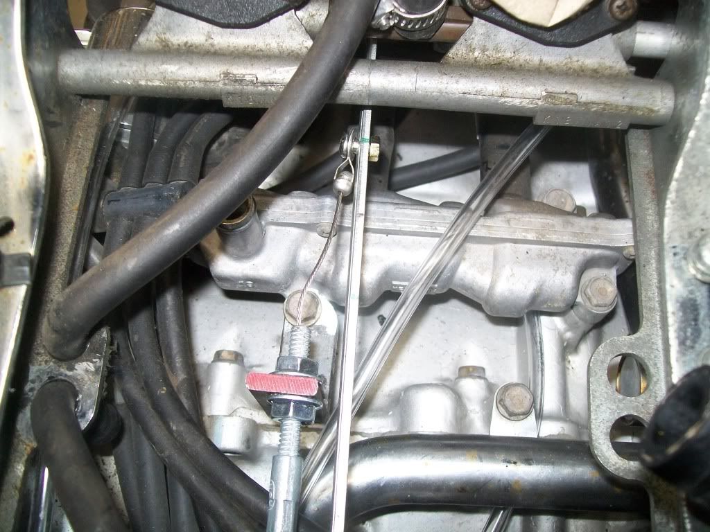

mine's not de-smogged, works perfect.
here's a picture of my linkage on the throttle.  i drilled and tapped it (4mm thread) and used the hardware that was provided with the kit.  i used a chunk of flat iron to make my mounting bracket (yes i know i'll rust, but i was too impatient to make one out of stainless steel.)
« Last Edit: June 25, 2013, 07:01:41 AM by alph » Logged

« Reply #33 on: April 23, 2011, 07:08:37 PM »
Wrenched on the lady for two days. Added a vacuum can and checked all the vacuum lines and electrical. If it doesn't work this time I'll add relay to brake line and then buy a break away unit. Test ride tomorrow will tell.  Crossing my fingers.

« Reply #34 on: April 23, 2011, 11:10:22 PM »
This might not be anything, but, how much slack do you have on your throttle bar?  The bar that ties between the carburetors sets.  Could there possibly be too much slack and your servo is bottoming out?  Just for kicks and giggles, shorten up your slack once and see what happens.

« Reply #35 on: April 24, 2011, 05:26:24 AM »
+1

« Reply #36 on: April 24, 2011, 08:18:01 AM »
I have cruise. Don't know if it was shorting the cable, added vacuum line or vacuum can. But I have cruise!  Thanks for all who helped.
