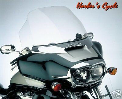

NEHI,  I'm 6'3" and run a showchrome w/s that is two in taller than stock and 4in wider on each side. I can still see over it if I have to by setting up sraight. I also have the baker air wings and lower deflectors on the fork tubes . I only get as much wind as I want. In the winter I do plug the fairing vent with some foam rubber to stop wind from it. Hope this helps.

+1 on the Show Chrome Windshield..... taller, wider, better.......  IMO
http://cgi.ebay.com/ebaymotors/Smoke-TOURING-WINDSHIELD-Honda-Valkyrie-1500-Interstate_W0QQitemZ370187106539QQcmdZViewItemQQptZMotorcycles_Parts_Accessories?hash=item370187106539
