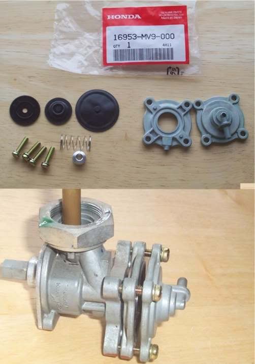

bad petcock diaphragm, causing a lean condition. similar conditions posted within the last two days by another rider. search the forum addressed many times.

had one doing that...needed to rebuild the petcock...also replaced the vacuum line to the petcock only the one I put on was too small...wouldn't open the diaphragm up all the way ...front two cylinders were starving for gas...put the right one on and things are good...
might want to look into that first...also be sure your vent hose is working on your tank...

You say there is a fuel smell. The question is where from?
-check under the fuel petcock for any drops and the golden look of the fuel stain. If so,then it's bleeding fuel from diaphram vent. Time to replace the diaphram.
-check the fuel lines obviously.
-If the fuel smell is from the exhaust, then the fuel is not completely burning, then start checking the plugs.
Just kinda sounds like the diaphram at this point, but let us know what you find out.

I ordered the petcock 'cover set' (was replaced when I did the desmog 3 seasons ago), as so many of you seem to think that is my issue (fingers crossed).  My buddy Jim C dropped off his infared thermometer last night, which should help determine if a coil is an issue (check the headers without blistering my fingers)...  I will report back, once I find something.
