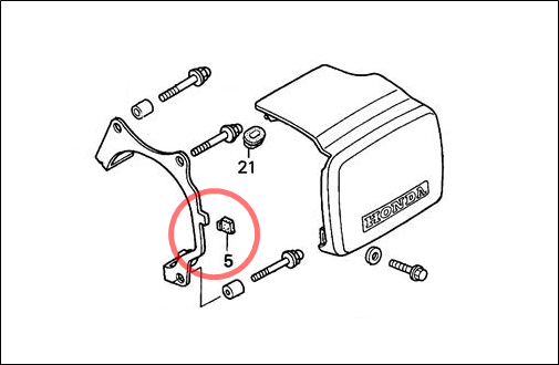

« Reply #1 on: May 30, 2011, 06:41:47 PM »
Perhaps, you didn't bolt the alternator cover back on right.....as with many who have preceded you.

« Reply #7 on: May 30, 2011, 07:05:38 PM »
one bolt on the bottom and a pin that snaps through a grommet... what am I missing?

RonW
Posts: 1867
Newport Beach
« Reply #18 on: May 31, 2011, 01:54:06 PM »
I forget what it was already, but it might have been something to do with the tab that has to line up with a groove on the inside surface of the alternator cover. The tab has a rubber cushion on it. **whoops, just read your separate thread on alternator covers.**
