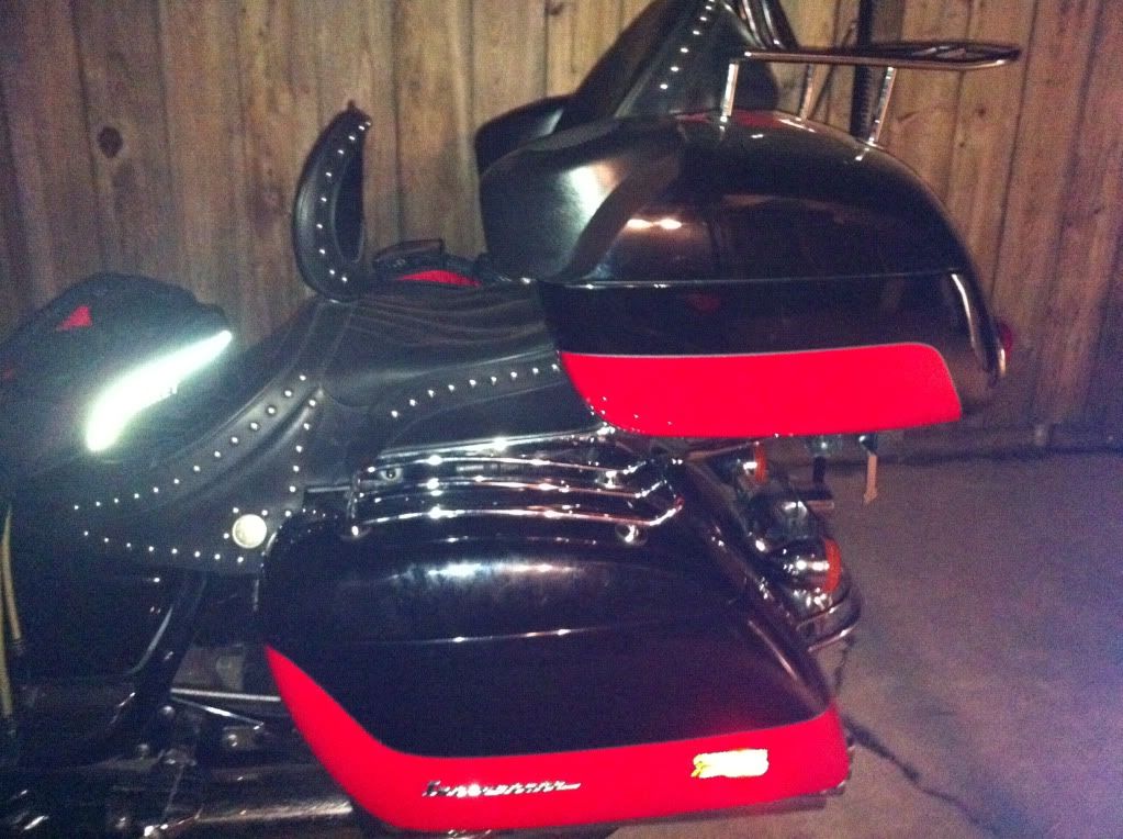

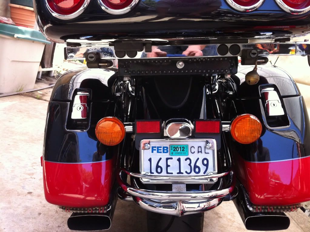

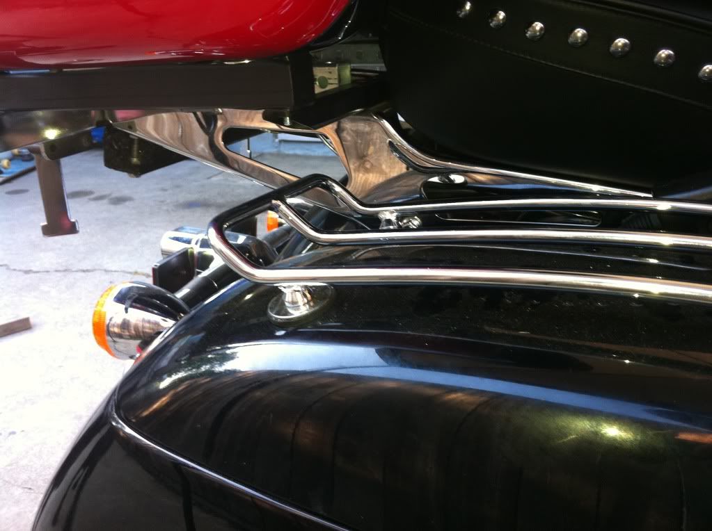

« Reply #7 on: July 26, 2011, 02:43:02 AM »
Well this task is almost completed,,, got it moved up 1" and back 1".
I found some square tubing that had holes in it every inch on the inch. I cut two long pieces and used some steel washers stacked on soem rubber washers for the front then I cut a short section to attach to the bracket at the fron of the trunk that attaches behind the passenger seat below the back rest.
I still need to add some support under the trunk at the original locations that were previously fully supported. Then a bar needs to run across the back side of the trunk to support it and also fill in the blank spot along the top of the cross bar that the helmet locks attach at and also the trunk release handle bumps up against...
I will get back on here later to ight and post up a few pictures of the material used and the finished project... I think it looks just about perfect and the wife will be MUCH more comfy now.

« Reply #10 on: July 26, 2011, 10:23:04 PM »
Yep, I actually remembered it and showed the wife the under trunk handle and she was like WOW! COOL!
Before lift and slide,
After lift and slide,
And yes I did recently add the trunk rack and the saddle bag top rack/rails, trust me worth EVERY penny. The wife really likes the storage and space I have added for her to be more comfortable...
