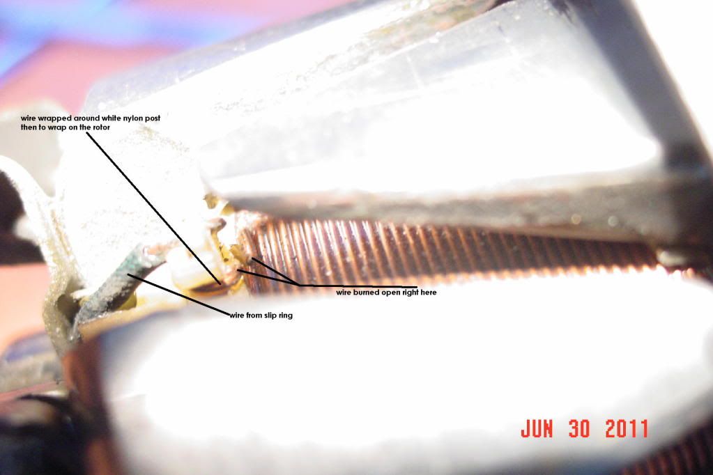

 A couple of years ago my alternator failed and just got around to investigating the issue.  Checking continuity between the slip rings revealed a open circuit.  Closer looking showed a break in the winding right at the white nylon post that supports the wire from the slip ring and then into the winding on the rotor!!!!!!!

« Reply #1 on: June 30, 2011, 05:30:02 PM »
Why not solder it back together?
-RP
Rio Wil
Posts: 1368
« Reply #2 on: June 30, 2011, 07:18:31 PM »
Not enough wire to make a physical connection to solder....

« Reply #3 on: June 30, 2011, 07:48:27 PM »

« Reply #7 on: May 07, 2012, 04:00:23 PM »
This is where mine failed.  It can be caused by a bad battery over working the alternator.  blackrams confirmed my battery had a bad cell.  Have your battery tested prior to using it with your new alt.

« Reply #8 on: May 07, 2012, 04:41:07 PM »
Well all wish we had a good rotor I have all the other good parts.  Buy the new one for the goldwing and clock it.  I wouldn't even think about fixing it.  Can we say stranded!!!  The place in West Virginia best price brand new OEM hitachi made in Japan.  Stay away from the China crap.

« Reply #9 on: May 07, 2012, 07:46:14 PM »
Already ordered the goldwing one and some dampeners.  Just wanted to be able to say that I found the problem with mine whether I fix it or not.  I am one who has to know what and how things work and how they failed.
I will post my findings when I'm done.  Hopefully this Sunday.
