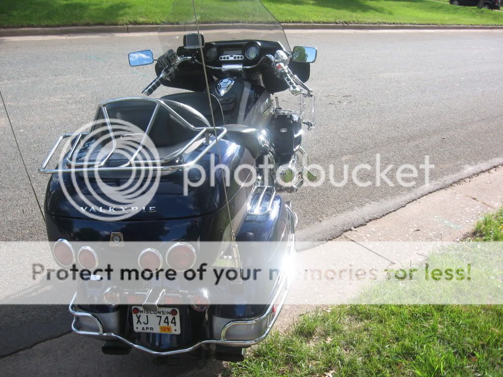

They'll fit any Standard/Tourer 2000 or newer and any Interstate. Those have the single screw setup mentioned above. I'm surprised more people don't have them since they look so much better than any of the other lenses available for the Valk. I think I paid $35/pair for mine.
When in doubt, ride.
Mr Whiskey
Posts: 2531
« Reply #4 on: July 07, 2011, 07:28:29 PM »
Thanks folks! Really appreciate the pic's Nitro. I'm sold. Gotta have 'em for the 2KI/S

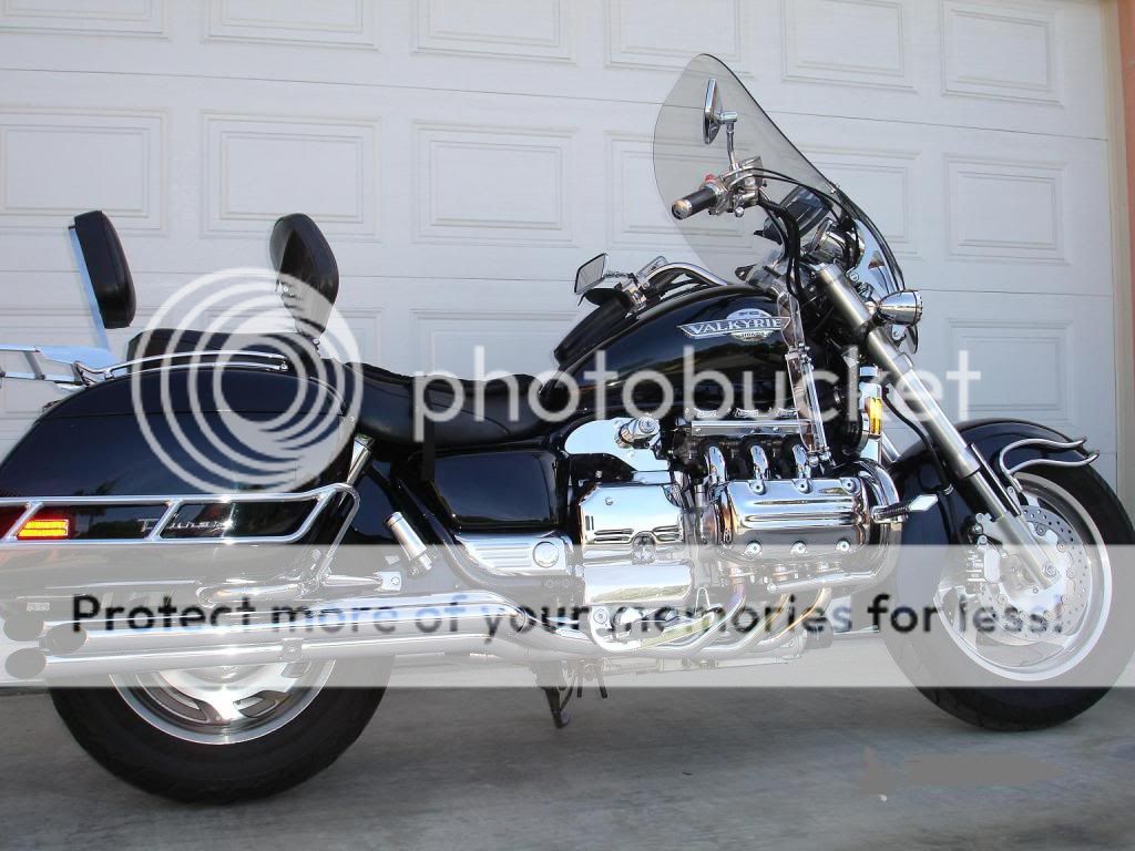

« Reply #6 on: July 08, 2011, 03:40:18 AM »
Whiskey, here's what I did and it's inexpensive and effective. Go to Walmart, the toy or model car section, and get a can of Testors model car spray paint. It's #1605 spray enamel, Tranparent Candy Apple Red. Clean the inside of the lens with some alcohol and let dry, then spray a couple coats on the inside of the lens....letting it dry somewhat between coats. Let dry real good before reinstalling. You now have a red lens instead of amber, you'll never know they were once amber. The paint...less than $5.
+1 on what John Schmidt said...I agree the Kury is the best looking option for the Valkyrie. It just wasn't an option on my bike (mine is not single screw)  I reluctantly used the Testors Candy Apple Red and am very pleased with the results. I also used it on my brake light lens, as this was a clear lens. It's not as good looking as the Kury, but it is a little different than the rest. I also cut off those UGLY reflectors from the license plate to clean it up a little. Then final dress with a pair of Chets Tube Toppers. Real simple and not expensive.

« Reply #15 on: July 08, 2011, 03:57:15 PM »
Thank for the infro guys. Just received my Kisan SM-3 programmable time-outs plus running light conversion kit. Want to replace amble lenses, now I know where to go. Tundra what type bag mounts are those? Great looking Valk. cooldude
HEY Crazyhorse.  I don't remember you parking in front of my garage door for that pic.  Smiley
