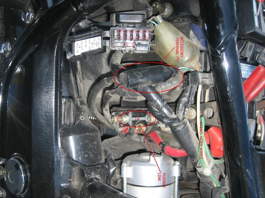

Where are the Aux leads under the right side panel???? I see the ones for the rear speakers and push to talk switch for the passanger CB.

« Reply #10 on: April 24, 2009, 07:04:15 AM »
Ignore the question marks.  Accessory lead where circled.
