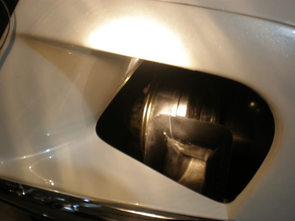

« Reply #6 on: July 17, 2011, 09:07:44 PM »
I've got your standard low tone Fiaam horn in the right pod.  Now this is on my Std that I added pods to.  I just took off the stock horn and replaced it with the Fiaam.   I think the horn came with 2 steel straps for mounting.  The horn shoots out the pod opening.
I'm not sure if the same mounting bolt exists on an I/S, and I can't find on HDL's fiche the horn on a Std to get a look at it.
How about using a "P" clamp on the area of the crash bar that is hidden by the pod as a mounting point?

« Reply #7 on: July 18, 2011, 04:07:12 PM »
P clamp, now why didn't I think of that. That's how we ran my trailer wiring, & my Brother's got a whole box of them in 27 diff sizes! Thanks for the pics Steve K, and thanks to everyone else for the info and ideas, they might just end up under the fairing. Peace, Whiskey.
