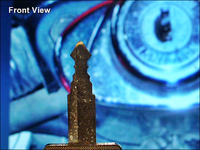

Do you think that rounding off the tip of the key would keep the 'little door' in its hinges? The profile of the key is tapered in the face view but it still is a little square at the point (bottom photo).
« Last Edit: July 19, 2011, 06:59:37 AM by RONW » Logged
I believe the little "door" actually slides to the side when you insert the key and has tiny springs that push it back into position when you remove the key.
The problem is that it's made of plastic and plastic gets brittle over time due to thermal cycling and  UV (sun) exposure.  Eventually it starts to crumble and either pieces of the "door", or springs, or both fall down into the lock and block the key or keep the lock pieces from moving as they are supposed to.
This happened to me two weeks ago. Thirty minutes with a dental pick set and spray lubricant cleared the lock.  If it hadn't, I'd have had to pull the ignition lock and fish around from the back side or dismantle the lock.
I think rounding the key tip only delays the inevitable as our bikes age.

I wasn't aware that the door of the key is more a pocket door than hinged.
As far as the flaking on the surface of the key, it's just the camera.
