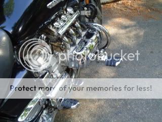

Any ideas on a good set of highway pegs or boards? I see the Kuryakyns for 250+, just seems spendy to me.
I have these and they weren't anywhere near $250.  I think they are great and would recommend to anyone.
http://cgi.ebay.com/ebaymotors/KURYAKYN-ERGO-W-DUALLY-ISO-PEGS-HONDA-GL1500-VALKYRIE-_W0QQcmdZViewItemQQhashZitem25661392b0QQitemZ160626348720QQptZMotorcyclesQ5fPartsQ5fAccessories
They can be configured to just about anyones height depending on where you put them. Only cost $145.00 for me.
