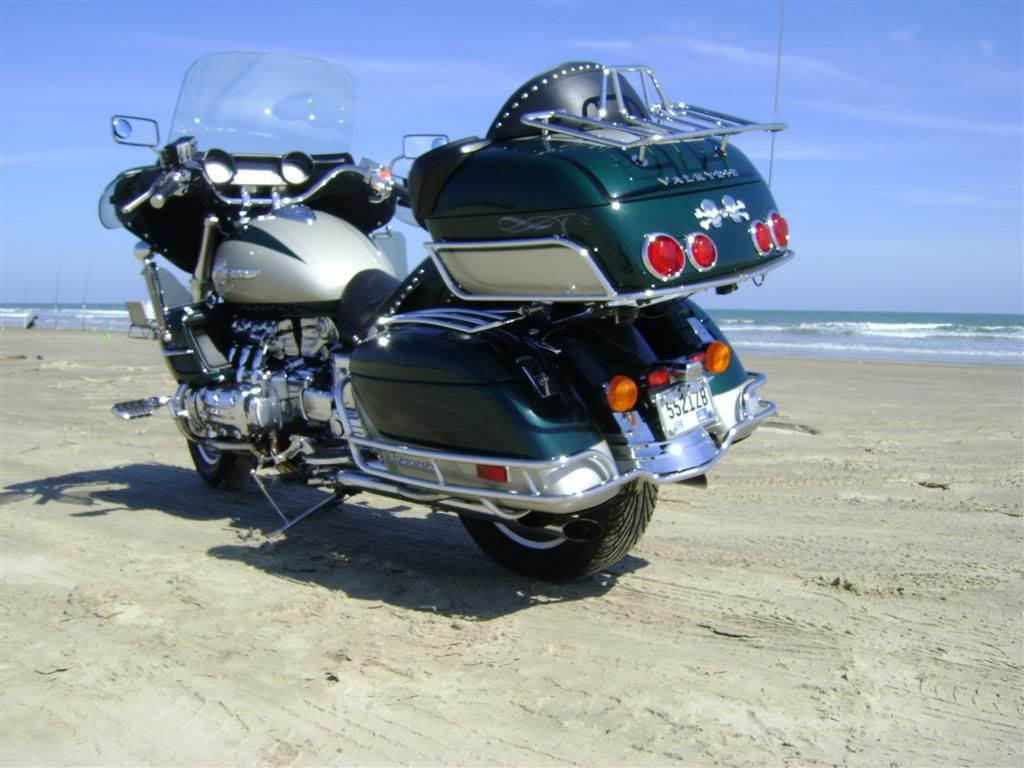

So my rear stock Avon is getting low and I am really leaning towards going to the Darkside.  I wanted some feedback on the Yokohama A048 from those that have or have ridden it and also the Toyo Proxes R888.  I have done lots of reading and checked out a lot of different tires.  I like the rounded look of the Yoko and the tread pattern.  I know about the lower mileage compared to other car tires but thats o.k.  I ride one up most of the time on an '03 Standard and I dont ride the curves.  Just straight up high speed cruising.  I would also appreciate posting some pics of the tire on your bike and what front you are running.  If your in southern NJ, I'll ride over and take a look at it.  Thanks, John

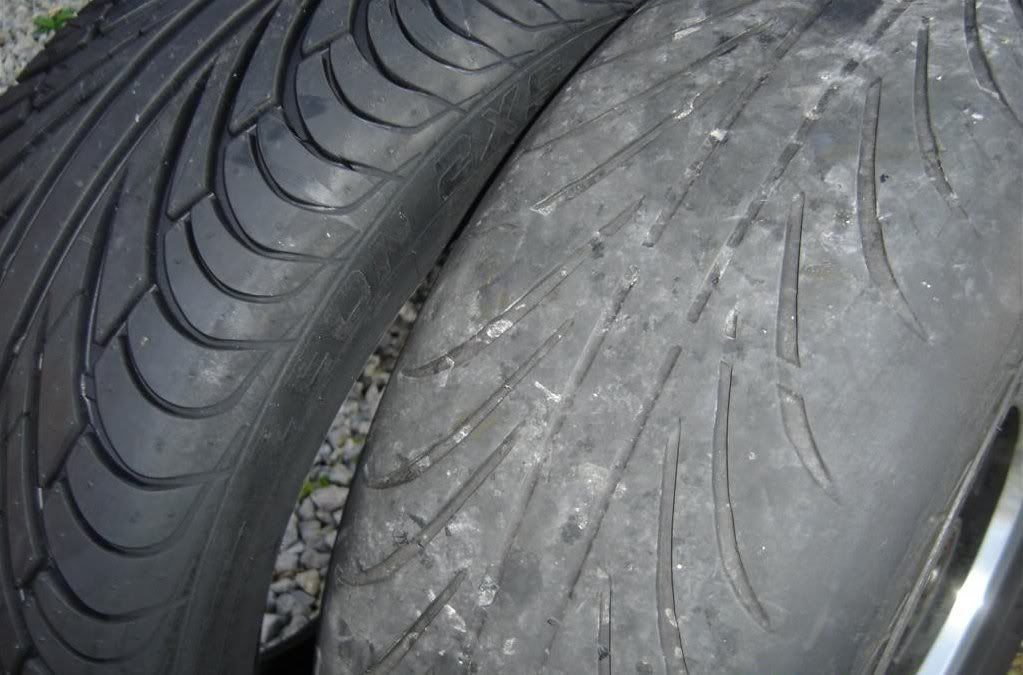

« Reply #3 on: April 27, 2009, 01:10:25 PM »
Goodyear Triple Tread.   Out of all the tires I have run, this is the best in my opinion so far.
This is my 9th or 10th car tire.   I run a Metzler front, more tread on the road in my opinion again.
the I/S by the Red bike has the same tire.  That is the best I can do as my mudflap covers it up.
The above is the actual tire.
