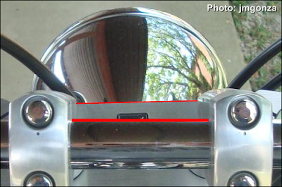

The only other possibility that I can think of for the handlebar not being 90-degrees to the front tire is the risers are offset from each other on the triple tree. Pic below from another forum that I'm on.
