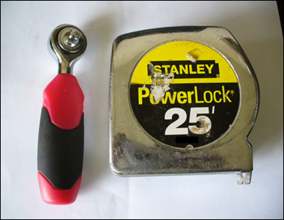

I don't think it'll make a big difference either, but when you're in the dark it's just another thing not to worry about if you leave the lock nuts in the stock setting. Btw, I used a stubby ¼-inch ratchet to press down the spring collar to remove the pesky seat stopper (slotted washer) under spring pressure on the right fork. The knob on the ratchet is round but it does the job just fine. Plus, it's only necessary to insert the ratchet into one of the holes on the spring collar, not both sides, so it gives you a free hand to grasp the seat stopper. You're only compressing the coil spring down 1/16th of an inch to free the seat stopper. The manual illustrates "pushing down the spring collar" using your hand. Can it be done that way? Also, the stubby ratchet is the kind you buy in the tool sale bin and has a rubber handle to make it slip proof. I haven't tried a plain metal ¼-inch ratchet.
