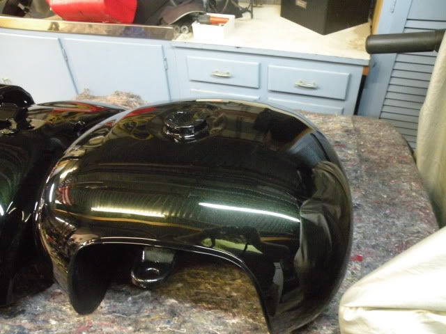

as long as the painter can colour match (if the rest of the bike paint has faded any new paint will appear different even if the colour code is correct) then it doesn't really matter what type of paint is used .Enamel is generally cheap ,as is acrylic and is easy to touch up if you get stone chips down the track ,2 pack is the most durable and has a very hard glossy surface finish but not easy to touch up later .Mine was repainted in a water based base colour(doesn't react to any other paint or contaminants already on the metal) and finished with 2 pack clear coat.very happy with results.
