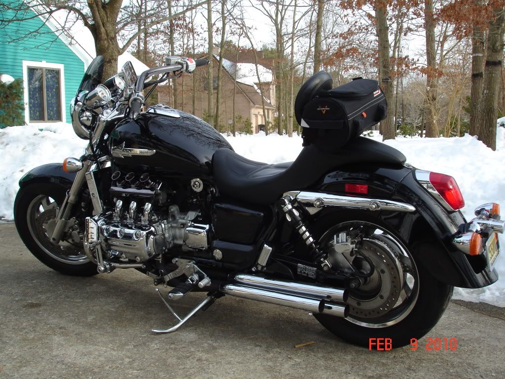

STEELERS- RUDE DOG......mate!! can u give me the specs on those drag bars.....eggszackery what I,m looking for...very nice indeed...

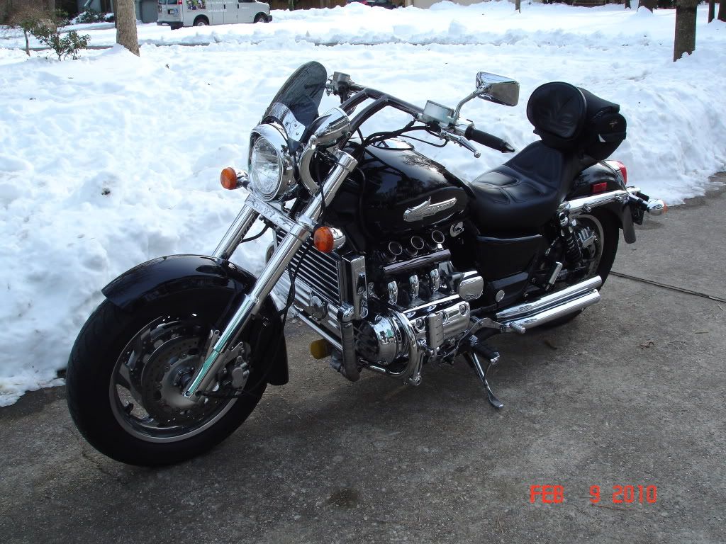

Those look very similar to my bars, Biker's Choice with 8" rise (see link after the pics):
http://www.cruisercustomizing.com/detail.cfm?model_id=12&Category_ID=10&manufacturer_ID=549&product_ID=28234&sblid_name=Biker_s_Choice_Custom_Fat_Pullback_Bar_for_Honda_____inch_Rise__Pullback_for_Honda_1500_Valkyrie_Standard
They are a big improvement for me. I also did the internal wiring (tedious but worth it) and did proper length throttle cables and brake/clutch lines. You can get away with ty-wraps for the stock lines and wiring but you really need the shorter throttle cables or they bind. I also deleted the choke cable altogether and just operate it manually now. All in all I've got a little over 500 bucks in the mod including all parts and a few hours labor. If you need info on lengths send me a PM and I'll provide you with what you need.

Mine are by Drag Specialties.  Model 0606-0490 and are an 8 inch rise and 8 inch pullback.  They were too much of a reach for me so I had to switch them out.
    BRAND Drag Specialties
    CENTER WIDTH 100mm
    COLOR Chrome
    MATERIAL Steel
    OVERALL WIDTH 33.5"
    PULLBACK/SWEEP 8"
    RISE/HEIGHT 8"
    SIZE OF BAR 1 1/4"
    STYLE T-Bar
    TYPE Handlebar
This guy has some nice bars that will work on our bike.

Hey Anvil, your ride really looks good with those bars. Kind'a mean and business like.  cooldude
Thanks. That's exactly what I was going for. That and the less "remote" feeling of the stock bars.

anvil: how is it on your lower back?
Well my lower back is never really a "problem" (as in chronic, but I'm human and as such my muscles ache like anyone else's after enough time) but it's actually a little better being pulled forward. I grew up on sportbikes and I like the reach to the bars. Actually I know some guys who have switched back to sportbikes because of lower back issues. The leaned forward riding position spreads the stress over your butt, legs, arms and back rather than focusing your weight on your back like a more traditional cruiser riding position.
My big problem is my left shoulder/trap area. After an hour or so I'd get a brutal pain just to the left of my spine and traveling up my shoulder. It's helped with that. Not completely alleviated it mind you, but helped.

Gidday...the one-piece seat.....can u fwd me some info...price/where to get etc....kia kaha

that's a corbin  stinger
