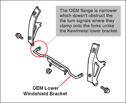

Dodis, is the "x" in the photo below a special adapter? I don't see how the stock turn signals could be used with the Kewlmetal windshield brackets, at least with the bracket meant for the lower mounting bolts. The Kewlmetal lower bracket is wider than the stock ones that they replace. The extra width won't allow stock turn signals to be attached at their factory position on the forks since the wider flange sits right at the very spot that the stock turn signals clamp onto the fork tubes.
The stock turn signal would have to be moved above the wider kewlmetal flange. However, if you move the turn signal up the forks, above the wider flange, than the turn signal won't clear the cutout in the OEM windshield in their higher position. I guess you could grind off the top of the wider flange.
[The STOCK lower windshield brackets are thinner actually rods to accommodate the turn signals' fitment into its notch in the OEM windshield. All in all though the bottom stock windshield bracket isn't too bad looking. It's the TOP mounting brackets that have a sheet metal finish to them.]

Yes, the "X" is KewlMetal's signal standoff for the turnsignals. Though if you have a short section of tubing you could polish up, you could do the same thing. If you are keeping the stock signals like I did, a tube might be better since you could get something to better match the diameter of the signal mount instead of tapered like the KM standoff, even flatten it a bit to match the oval shape.

no need for more pics, but thanks the same. I understand that the Kewl brackets have two holes on the right and left bolt flanges. The lower is for the windshield on that side of the bike. The hole directly above is for the turn signals (with adapters).

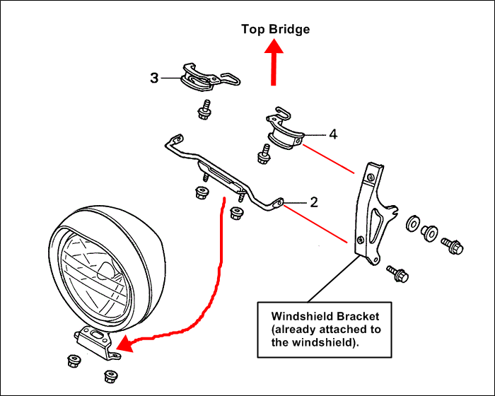

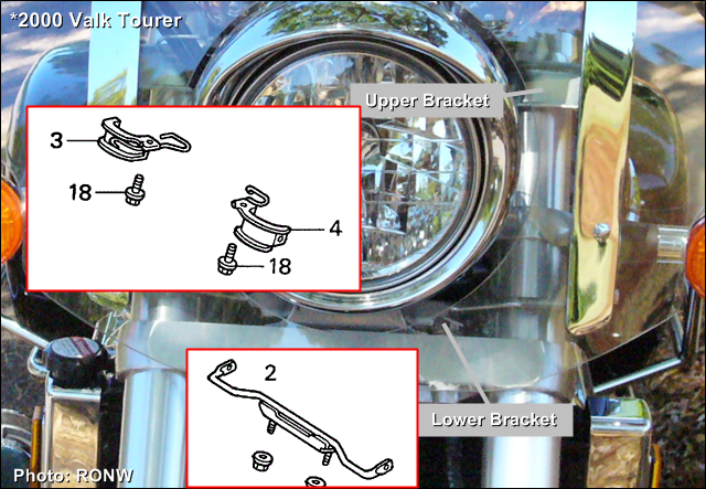

Not trying to hijack, but am picking up an oem windshield next sat. The lower bracket (#2) obviously replaces the turn signal support bar. Where do #3, and 4 attach. Also is this something thats easy to install on a Std. On the side of the road somewhere????

« Reply #11 on: October 27, 2011, 07:29:39 AM »
Pics are from my photo files which I annotated. *I forget already, but if the bottom bracket uses the same headlight bolts, it's worth double-checking and re-checking those bottom nuts and bolts so your headlight don't fall off.
