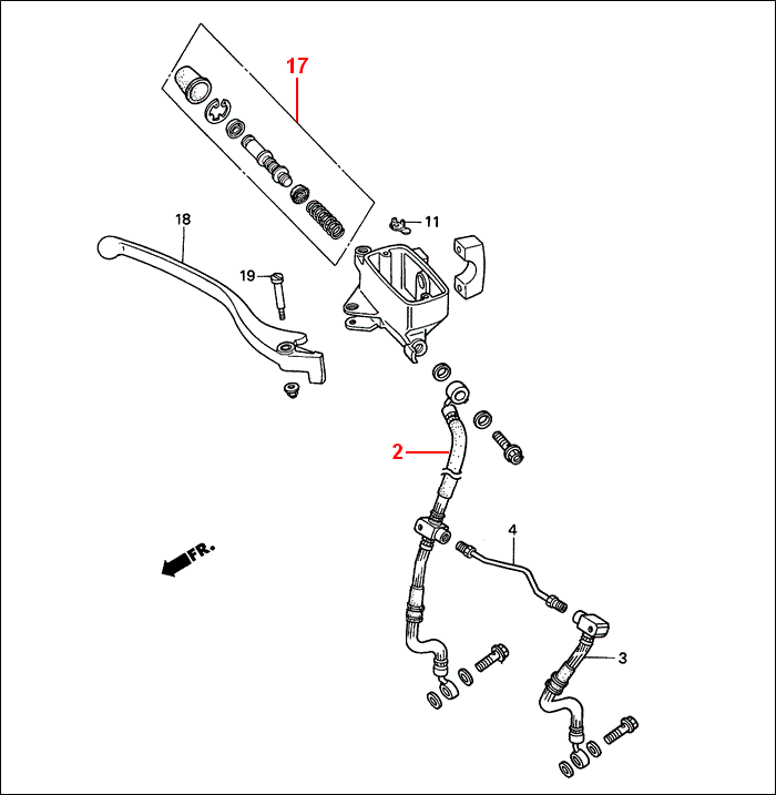

.... brakes do not catch until brake lever fully engaged.  wish i knew someone i could bring the old girl to that would be able to accurately diagnose.
at the least we can attempt a diagnosis over the Internet before spending all the money on replacing this and replacing that, plus labor costs. There might be a better option. My thinking on .... "do not catch until brake lever fully engaged" .... is possibly due to a defect at #17 or at point #2 (brake line) in diagram below since a defect there would affect the hydraulic pressure on both side's front brakes. The engagement tab on the brake lever could be worn where the tab pushes the piston into the brake master cylinder. Or the contact points could be slipping pass each other for whatever reasons. Or a worn bushing for the lever bolt #19. Do you have stock brake levers? Have you tried pumping your lever to see if it makes a difference if it does it's definitely the master cylinder's piston.
[Edit] oh, wow .... 180,000 miles! Didn't see that however the rotor would wear out too thin?

« Reply #7 on: October 29, 2011, 01:39:45 PM »
Earl, I think that the piston isn't retracting full back out but hung up for whatever reasons. That's possibly why the brake lever doesn't engage until it's squeezed all the way in. The tab on the lever may not be overly worn. I guess billve could remove the lever and fiddle with the end of the piston under the rubber booth. Btw, where is bill v e?? Has anyone seen him lately.
