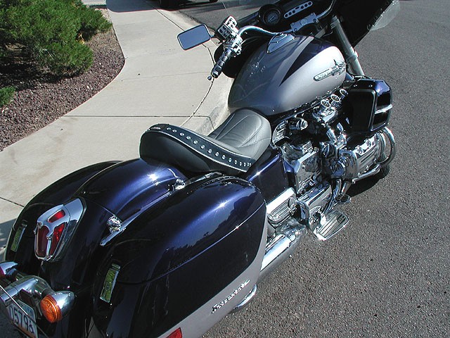

Posts: 22104
« Reply #8 on: November 15, 2011, 03:54:00 PM »
This is a pic I took nearly 10 years ago of TNT (Vicki)'s Valkyrie, if it helps you any...

F6GAL , by checking your profile I'm assuming you are a lady, right...Is it possible to share some pictures of your bike so can I see your modifications ? My OEM absorbers are almost new , do you think to cut them is a good idea ??
Thanks for ´ur feedback
I can't find a great pic of the forks, but you can kinda see them in this pic.  The seat in this pic is a custom Corbin, but I've since changed to a custom Ultimate.
More pics here: http://valkyrieriders.com/f6gal/SS_BS_Seat/index.htm
Slipping the forks is pretty simple.  Use a bike jack to support the front end; lift the bike slightly so the weight is off the front end. Loosen the fork bolts, then lower the jack until the top of the forks are 1/2 to 3/4 in. above the triple tree (3/4 in is the absolute MAX b/c of the tapering).  Retighten the bolts as tight as absolutely possible, then drop the jack.  The forks have been slipped on all my Valkyries and I've never had an issue (even hit a deer at 60 mph, bent the forks, but they didn't budge from their position).
