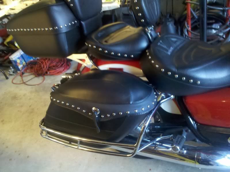

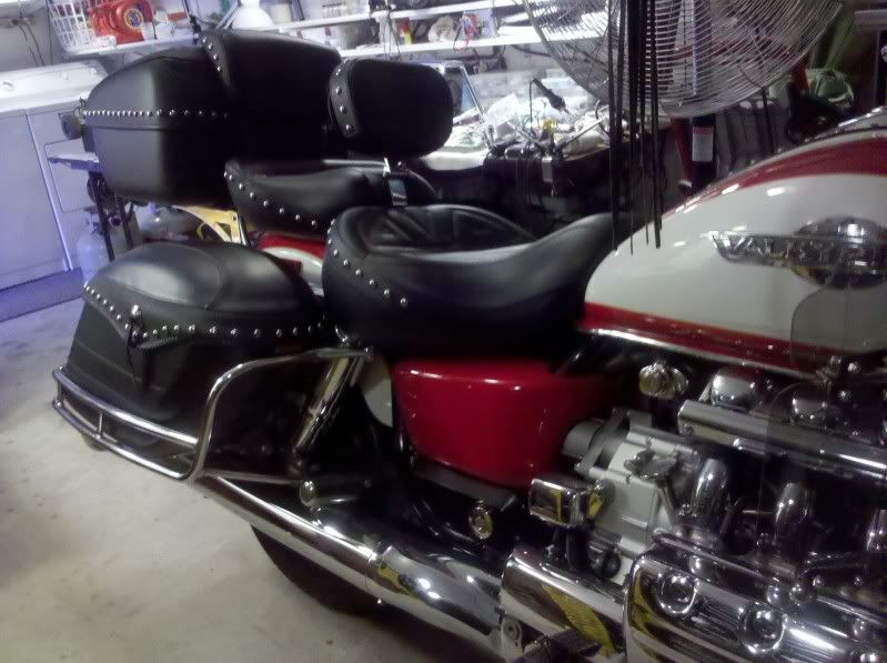

I'm trying to make the rails go around a set of these.....
If you can get'em to fit thats going to look pretty cool with all the leather  cooldude  I saw Fudgie post something about spreading them out however I don't remember the details.

judging by the absence of 'saddlebag brackets' (in the pics), the owner might have went out and purchased those Hondaline saddlebag rails. The saddlebag 'rails' shown in the pics are actually saddlebag guards. They're not designed to support those OEM hard bags that you see on Tourers unless you plywood the open bottom. Tourer hard bags are supported by factory brackets that are hidden from view. They're like large L-brackets with a sheet metal running board bolted onto the horizontal leg which the Tourer hard bags rest on.

Yes, I know that they're not designed to support the bags.  I have them mounted to OEM leather bag mounts that I've modified to mount these bags on.
The rails (or guards) ARE OEM I assure you.  I've seen them used on Champion hard bags before and look good.  These Mustang bags are just a touch wider than the OEM and Champion bags.  If I can get them to spread out at the rear (as others have done when used with a Hitch Doc), then I'm going to use them on the bike.

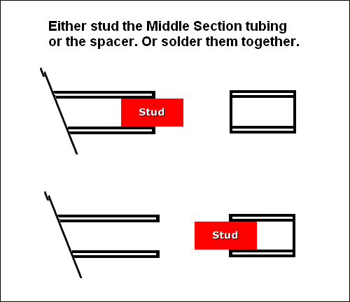

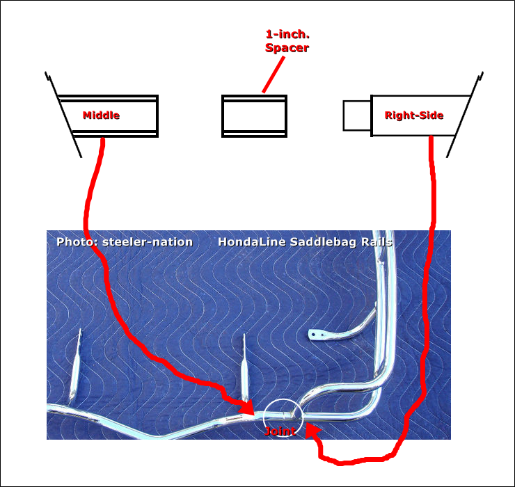

.... here's my idea (uh-oh) of how it should be done.
