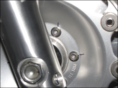

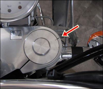

RonW
Posts: 1867
Newport Beach
« Reply #15 on: December 06, 2011, 08:10:10 PM »
Wondering how I'm going to get my torque the 4 bolts holding the swing arm after the wheel is on?
Not a lot of room to operate.
I've been using olde fashion witness marks to line up (torque) the bolts. Don't have pics of the "4 bolts" but something like the pics below. I do follow up with a torque wrench wherever possible. With the 4 bolts though, I suggest you line up the felt pen marks as straight as possible, with a 47 ft-lbs torque value, cranking the bolt to the other side of the line may amount to 5 to 10 ft-lbs difference. Just guessing on that but better to keep on the safe side.
2000 Valkyrie Tourer
