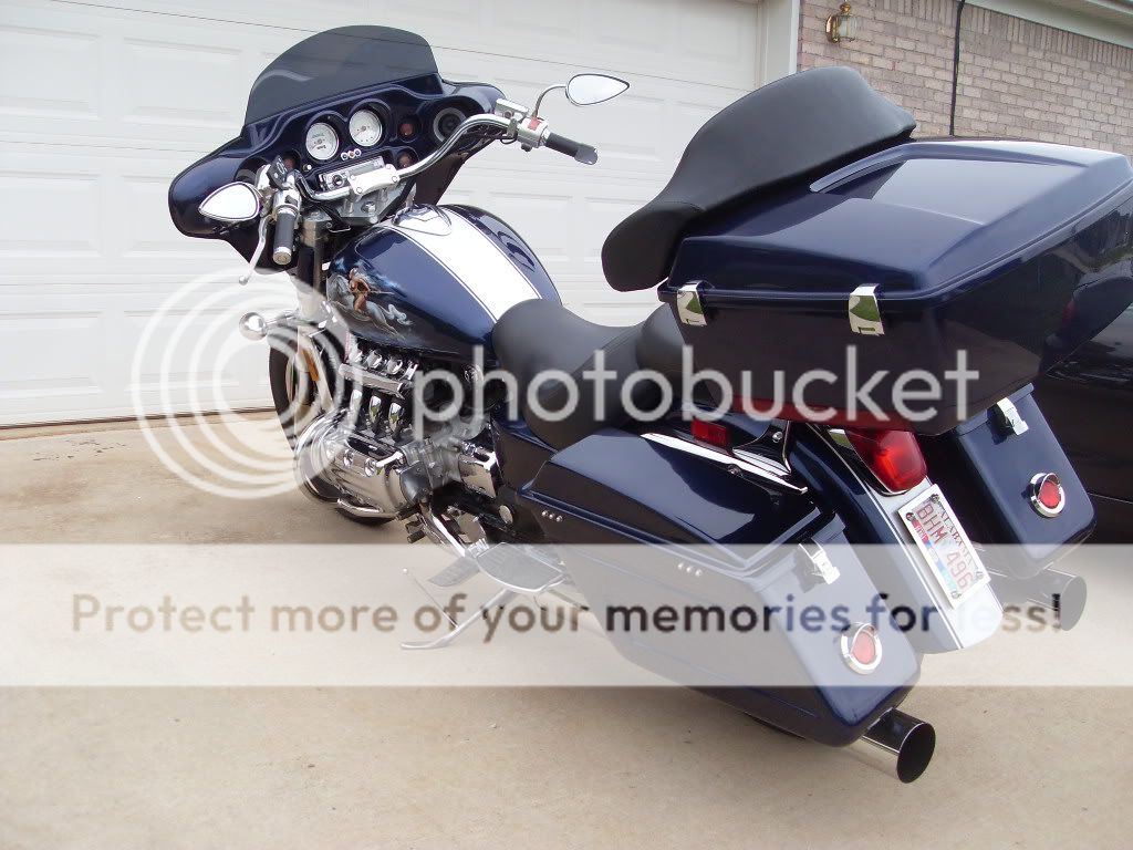

« Reply #5 on: December 08, 2011, 09:41:56 AM »
Hey Bernie,
 sounds like some good mods. I've often thought about a belly tank, but always talk myself out of it. I think I need to stop about every 100-125 miles to help fight fatigue.
Here is a picture of a members bike from Huntsville Alabama, he did a great job on it. The only time I've seen it was at the wiskey run a couple years ago. The gauges are stock valkyrie. If I ever put one on my tourer it will be like this.

T-bird,  The inner fairng I am getting will look just like the one in your picture. It should be here in the next day or two along with the belly tank.  I like stopping regularly too, but like the idea that I will be able to go longer if I need to.  I'm looking forward to doing something special to the fat lady.  Almost forgot.  I have some extra baker air wings that I am going to modify to block the wind on my hands during the winter if the fairing doesn't knock the wind off.
