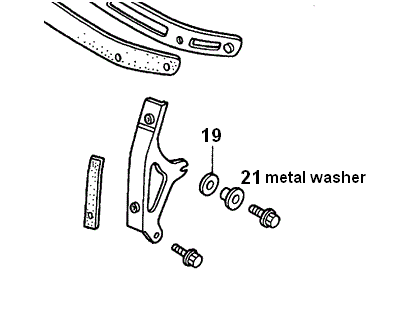

the rubber washers that are available don't have a large enough I.D. I had to drill it out to retrofit the windshield bracket bolt. Whatever it is, there's nothing that beats the material used in the OEM. The faucet washer that I used start a crease when they're compressed.
Ideally, it's better if the O.D. of the replacement washer (#19) is less than the O.D. of the metal washer (#21) so the metal washer's circumference doesn't cookie cut into the rubber washer.
Where did you get this picture?  I am in need of the metal washer and the bolt.  Thanks.

the washers are available at OEM parts sites. The tricky part is the windshield page is not listed as Windshield but "GL1500CT WINDSCREEN," as in, starts with a "G" if you're searching for the Windshield Page alphabetically. Several OEM websites below, verify the shipping cost first before yo press the pay button. The links below are direct links to the windshield page themselves. I never liked it when people posted URL's and you end up navigating or not navigating to the specific page. Why do they do that.

Hey mine has never had part no 19 or 21.  Angry What is  the  purpose for thoser washers ?

the top bolt fits into a slot thats open at the outboard end. Actually this makes it easier and quicker to detach the windshield since you only have to fully remove the two bottom bolts of the 4 bolts total. The slot allows you to angle the windshield a smidgen, but then the top bolt sits correspondingly midway etc in the slot with little to keep it from shifting to and fro. The rubber washer keeps it in place by absorbing vibration. The metal washer has a ¼(-)" metal tube protruding from it (pic below) and the tube inserts into the windshield bracket slot. The rubber washer fits over the metal tube and sits sandwiched between the metal washer and metal windshield bracket. I surmise things are more secure that way. I dunno if you can use the metal washer without the rubber washer that infills the space. On the other hand, the rubber washer can be used without the metal washer.
