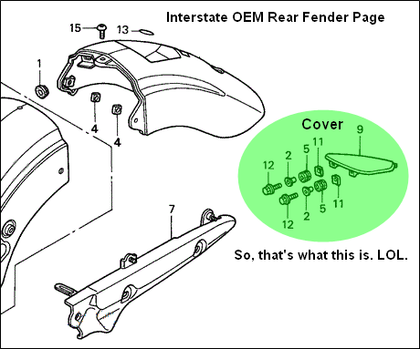

Excuse me for asking, but doesn't an I/S already come with the same tail light that's on a Standard/Tourer, for example. Standard tail light units aren't listed on I/S oem tail light pages which leaves the impression that it's not standard issue on the Interstate.
At any rate, from your Ebay link and an OEM parts diagram, the Aero tail light attaches to the rear fender via Bracket #4 ('98 Aero Tail Light Page). For whatever reasons, the bracket is not sold on OEM tail light pages for standard nor tourers. The jog in the Aero's bracket may be there to clear something on the Aero fender. However, the spacing between the two bolt holes appears about the same for where Bracket #4 would attach on a Valk fender. That's just going by pics, of course.

The IS has the rear tail lights (turn and license), but does not have a brake light on the fender. Honda placed them in the trunk only, 4 lights for running/brake. I love that the brakes are higher in the trunk, I think it places it more into the line of sight of cagers.
Some people like to remove the trunk, and then mount the brake light on the fender. I ride 2 up and want the trunk for myself too, so I just want more visibility. Thats why the top trunk GW light, fender brake light, and the modulated brake LED light I've seen on fellow riders bikes.
I like your pics above. Yes, I noticed the Areo, seems to me with out any bike/light to look at, as being the same as the brake light I did buy for my IS, but sold as I wrote off my bike in an accident. Now I'm taking the time till I buy again, to get some of those hard to find at a good price items, and rare ones also.
But the fender you posted is the front section, not the rear. If I knew how you posted those (no photo shop) I would try myself. The rear section on the IS has a cover plate where the brake light mounts. If I remember correctly, the cover plate has those same 3 bolt holes that the Areo light looks like it would fit right into, no mod.
I was hoping someone would have tried a few of these, and be able to tell us whick one is the correct one. Maybe I'll buy a Valk one and then go down to different dealers with the Shadow light and check them out, just so this question can be answered.
I think this would make a very inexpensive replacement for us, along with those wishing to Super Valk their bike. They would not be as rare and expensive as a Valk tail light.

« Reply #13 on: December 14, 2011, 03:36:05 PM »
The IS has the rear tail lights (turn and lisence), but does not have a brake light on the fender.
But the fender you posted is the front section, not the rear. The rear section on the IS has a cover plate where the brake light mounts. If I remember correctly, the cover plate has those same 3 bolt holes that the Areo light looks like it would fit right into, no mod.
whoops, my bad. More like these below ....
