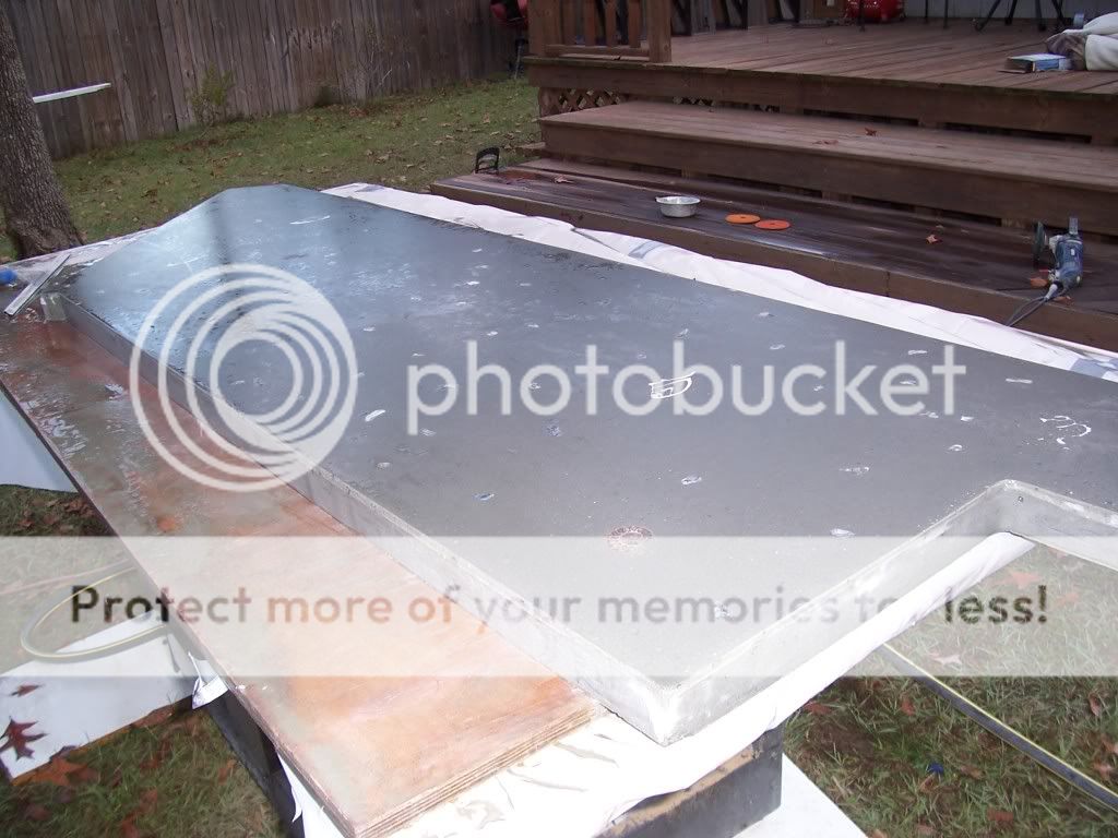

I just finished my first kitchen for hire.  I did concrete countertops in a Florida Room.  This guy is making a bang up kitchen for parties in his Florida Room, and he wanted rugged countertops that could handle heavy use.......CONCRETE.  I had  a blast making this and as soon as the rest of the slow pokes get their parts done we can have the inagrial party!!!

Jeff--Sorry to say, but those pictures just don't your work justice!!  As you know, I've seen the real product and the finish you put of it makes it look more like the best marble or granite $$ can buy!!
Posts: 14935
« Reply #5 on: December 20, 2011, 06:01:59 PM »
thanks....well, to get the whole thing in the shot you give up some detail
Posts: 14935
« Reply #6 on: December 20, 2011, 06:08:24 PM »
Earl....this pic shows more detail of the finish even though its not as nice of a picture

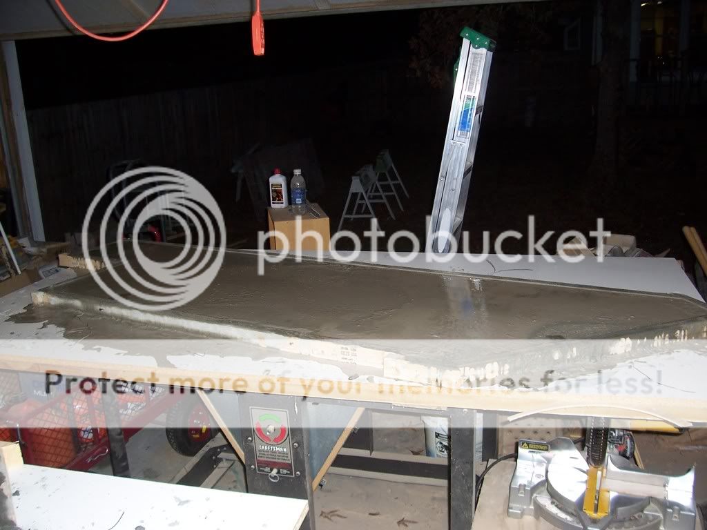

I'm imagining that stuff coming out of a pumper truck with special add-mixtures and
aggregate... how did you really mix it up?
Posts: 14935
« Reply #10 on: December 22, 2011, 10:35:19 AM »
Mike I have a small 2.5 cu.ft. electric mixer.  All that is used is standard 5,000psi concrete, the color product and whatever custom inlays and aggrigate you want to add.  The shells you see are hand placed in the form before pouring.  Yes its a lot of work, then getting that big thing out of the form turning it over and grinding it smooth and shiney takes all day.

« Reply #12 on: December 22, 2011, 11:13:32 AM »
Thanks Mike, ya I have to use some expensive diamond impregnated grinding pads to make any progress on that stuff.  The upside is, I think youd have to try hard to break it, the down side is its a heavy beast.  That piece is around 350lb and it was a bear for me and my friend to haul op 4 steps and place it in its final resting place.  We didnt bother removing it once we had it right to use any silicone.....didnt think it was going anywhere

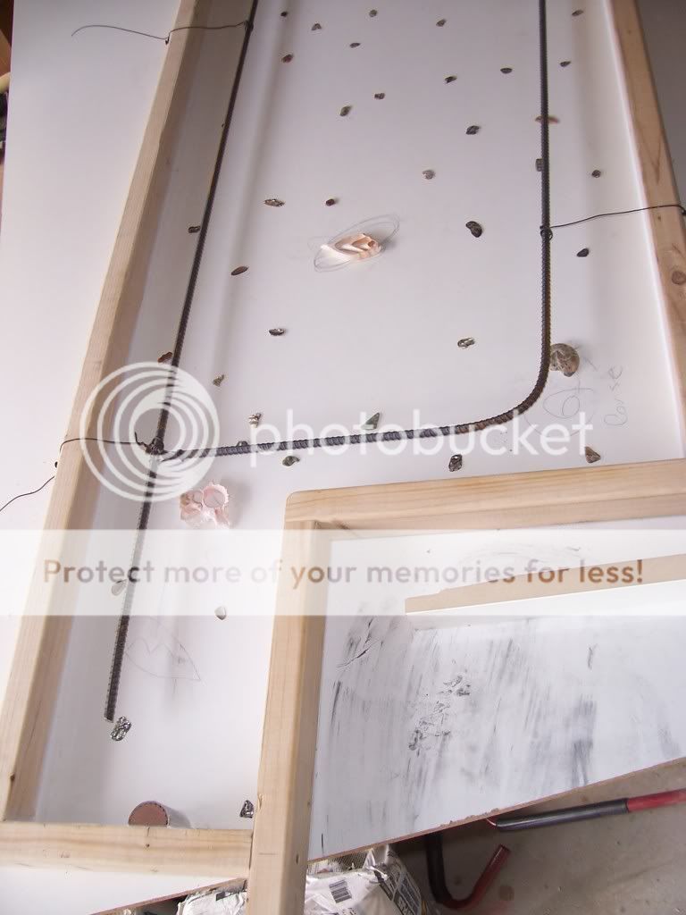

« Reply #13 on: December 22, 2011, 11:36:14 AM »
Will you describe your forms and material used to make the form and any release agent or anythig? Once your concrete is set up, do you grind it while it is still green? Do you have to mix a slurry or anything to fill tiny voids? Do you use wire reinforcement? Inquiring minds need to know. I love the look you created.
Posts: 14935
« Reply #14 on: December 22, 2011, 11:55:12 AM »
Jimmy,
The forms (you can see in the picture) are melamine and the sides are cut to spec 2X4's with packing tape on the contacting surfaces.  All seams and cracks calked with silicone calking and a minimal amount of rebar (just in case) but I dont think the rebar is needed.  Yes there is an acrylic slurry that comes color-matched to the product I buy and you have to fill air holes before the final grind and polish.  Not sure what green is, but if you mean right after getting it out of the mold....yes, cures for 4 days and then grind it up seal wax and polish and its like glass.  Only one picture in the begining of the post actually showed the true finish, that was the one with the stainless cooker inset into it
